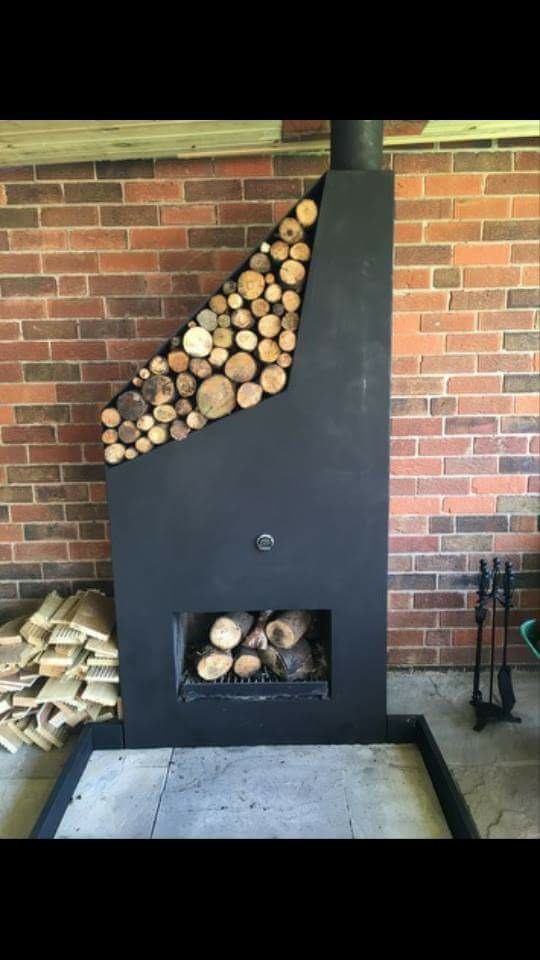

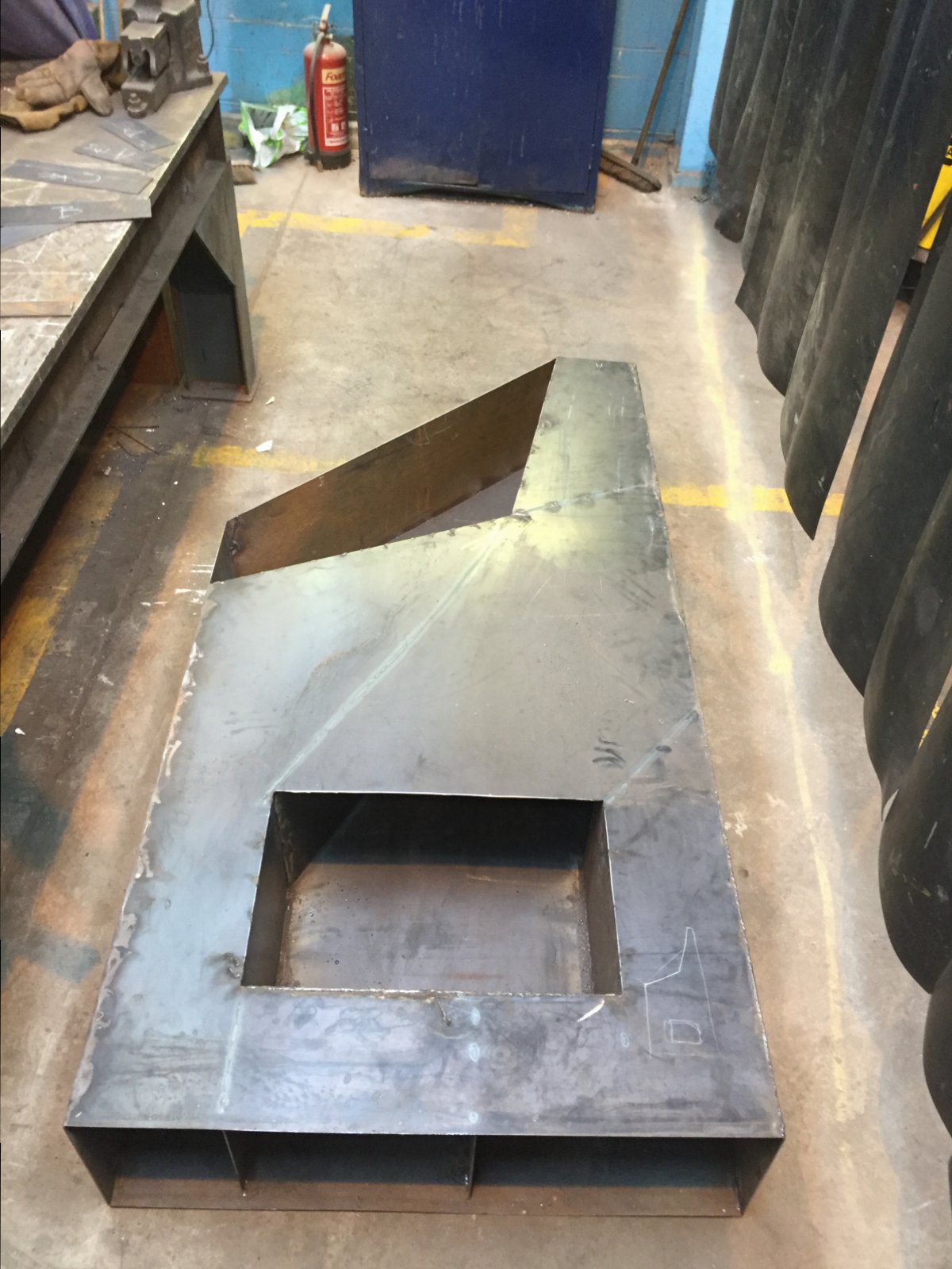

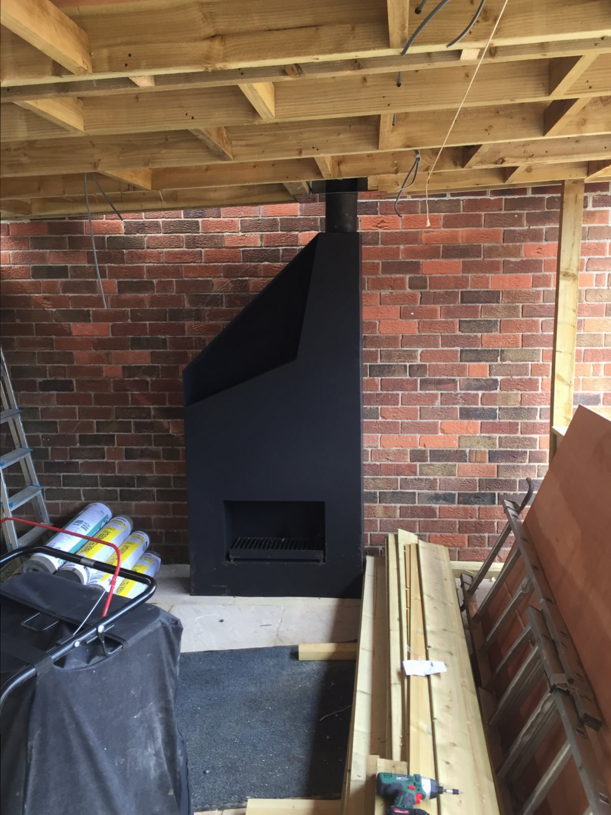

Was asked to create a log burner for use inside a pergola with a flue that goes outside. Made this out of 2 8x4ft sheets of 3mm mild steel sheet, fully welded with stick and finished with plasticote heat proof paint. Enjoyed the build and install.
