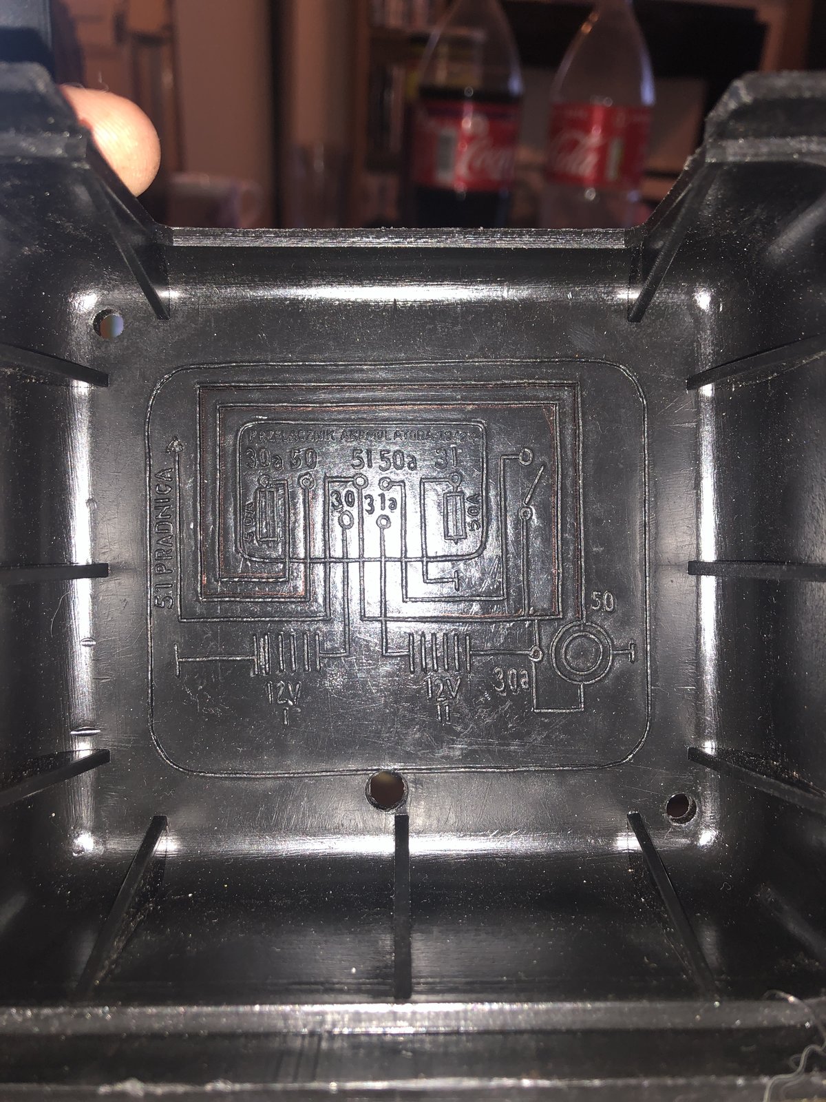

Tinbasherdan Bodger in chief Messages 7,383 Location Bolton, England Mar 9, 2019 #1 anyone got experience of these? theres a diagram on the lid but its not the easiest to follow!
Tinbasherdan Bodger in chief Messages 7,383 Location Bolton, England Oct 12, 2019 #2 bumptey bump..... still struggling to work this out. im struggling to work out where the 12v main harness feed is coming from

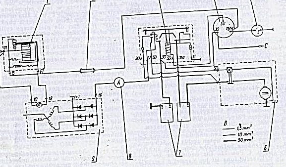

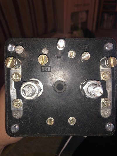

Tinbasherdan Bodger in chief Messages 7,383 Location Bolton, England Oct 12, 2019 #3 So this is what I have: 30 is batt 1 +ve, 31a is batt 2 -ve 51 is alternator 50 is to starter main live (?) 50a is to stater solenoid (?) 31 to chassis ground 30a might be to ignition switch/ min harness live? image.jpg 438.1 KB · Views: 170

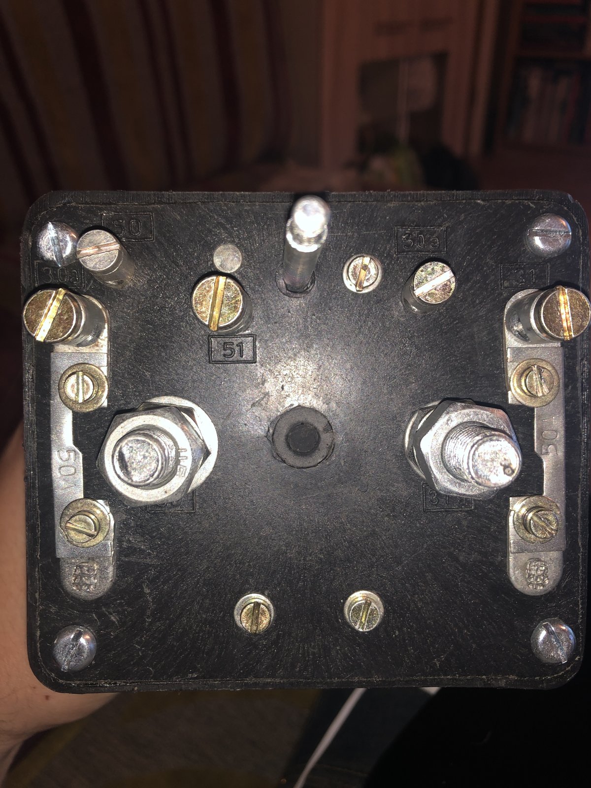

Tinbasherdan Bodger in chief Messages 7,383 Location Bolton, England Oct 12, 2019 #4 This is the relay top image.jpg 383.1 KB · Views: 111
Tinbasherdan Bodger in chief Messages 7,383 Location Bolton, England Oct 12, 2019 #6 That makes a bit more sense! I take it you have a zetor wiring diagram because I sure a hell couldnt find one online
Tinbasherdan Bodger in chief Messages 7,383 Location Bolton, England Oct 12, 2019 #7 any chance of a wider picture @8ob ?with the number descriptors?
