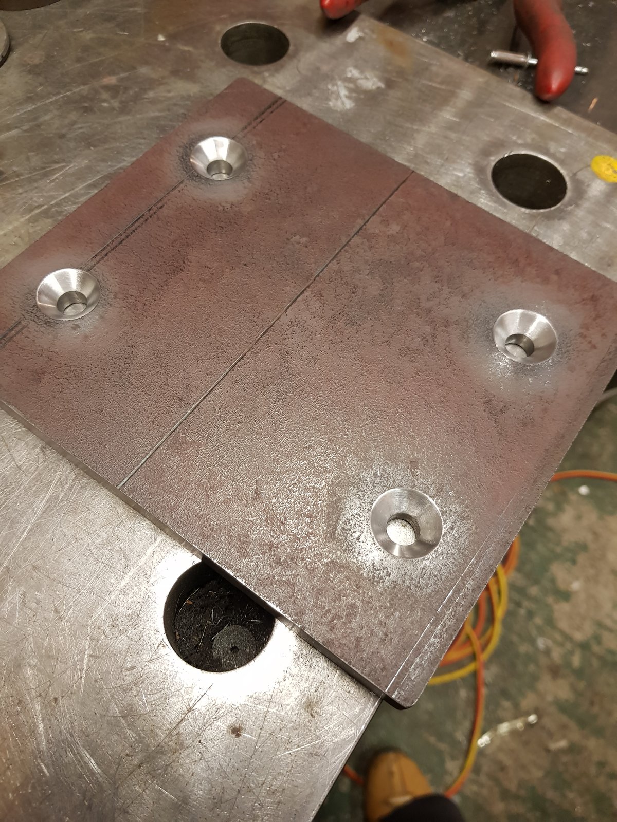

Can you guys recommend a good set of zero flute counter sinks for metal.
Yes Matt. Cone. I am looking for a tool supplier that would stock themIsn't that known as a cone? :P
(I know what a zero flute is before anyone jumps in!)
I'd imagine all your top brands;
Volkel
Presto
Dormer
Goliath et al
would all have sufficient ones.
Found some. RGD tools . I got 3 flute counter sinks but get a bit of chatter. So had to resort to a little filing .If it's for casual home game use then the cheapest set from eBay is working absolutely fine for me.
Will give those a look to. Thanks.I got some Keo zero flutes from MSC, work a treat in steel. You can buy them individually or in sets and different angles.
Just been looking on there website. They have a good selection of gear.Not cheap but seem to last. They are 5% cobalt so M35 HSS. I've only used them on mild steel and aluminium so far but haven't let me down. I only use them in the pillar drill at slow speeds with a drop of rocol.
