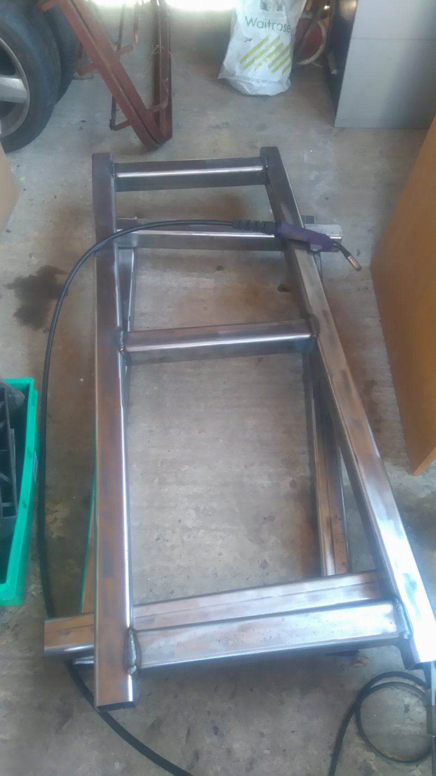

Just thought I would deposit some photos of my new welding table here. I took lots of ideas from other people's builds on here so thought I might repay the favour.

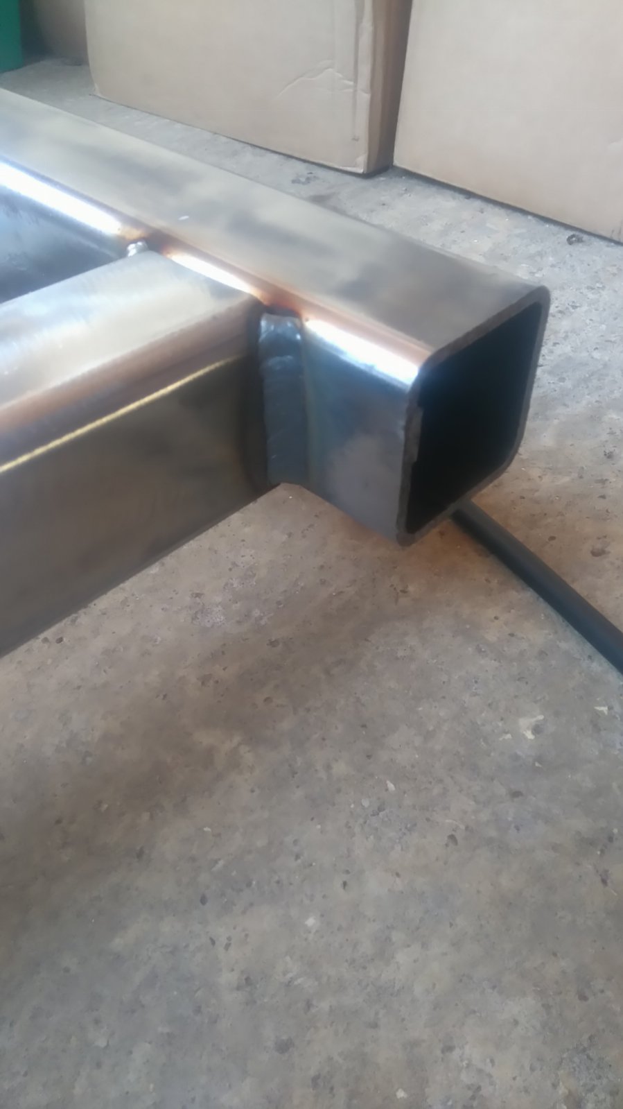

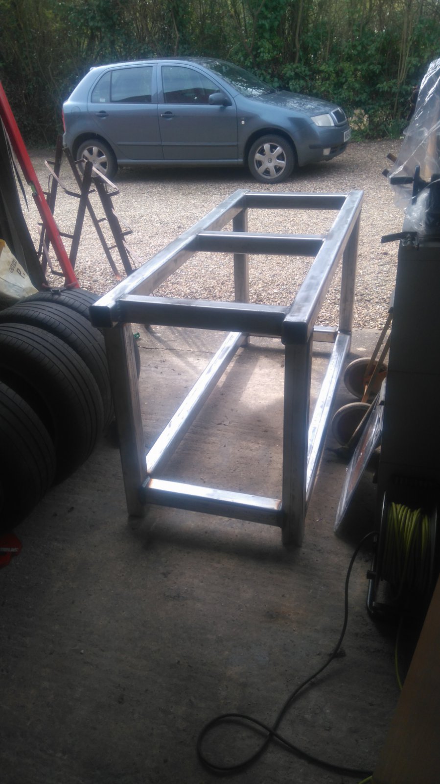

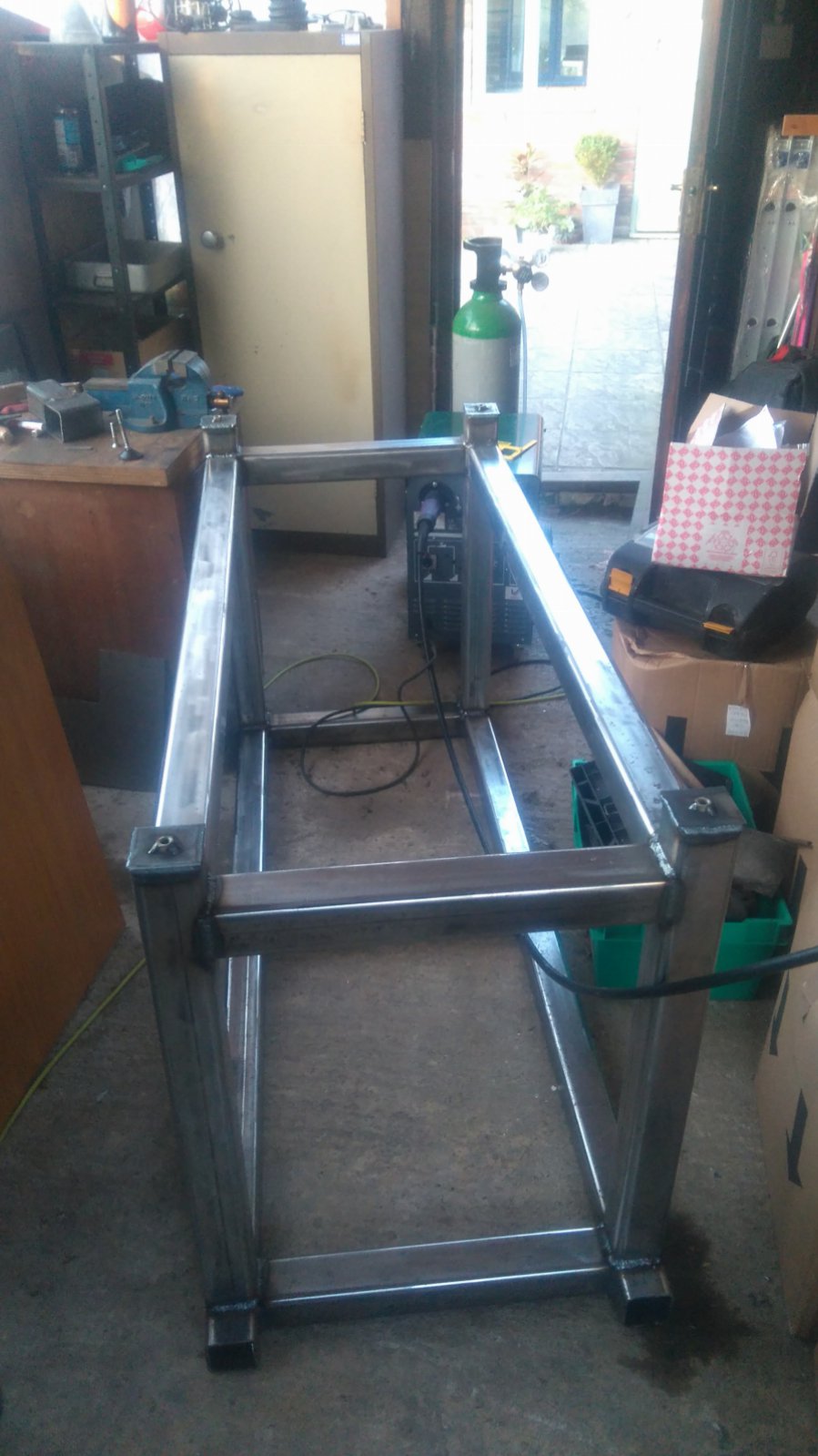

Made out of 70x70x5 SHS
Verticals will have adjustable feet screwed in. 5mm plates with hole and nut welded onto the bottom of the verticals. Castors will be placed on the long horizontal sections.

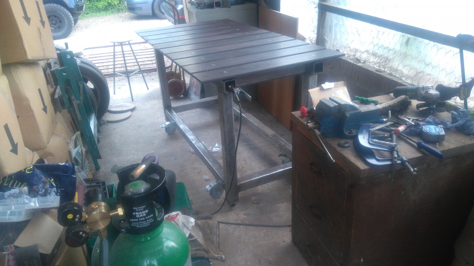

I skipped out a few pictures here as finishing the table got dragged out over time and I forgot to take them. Basically I drilled and countersunk two 10.5mm (clearance for M10) holes in each piece of 15mm flat. Then I drilled corresponding holes in the top surface of the SHS frame. Welded nuts on all of the holes and cut up pieces of flat to act as spacers between the top and the frame to allow clamps to slide in channels between the pieces of flat.
It certainly has made my projects since much easier!
