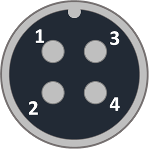

Welder has a spoolgun connector (4 pin GX160/Aircraft).
Anyway the machine migs and arc welds real well...
After a lot of hassling the national rep (idiot), I got the pinouts of the spoolgun connector.
Welder has a mig/spool gun switch and a weld process select touch switch on the panel
Here's the details from them
Pin 1: Switch
Pin 2 : Switch
Pin 3: Motor power supply, Negative (-)
Pin 4: Motor power supply, Positive (+)
Torch motor 28Vdc
The welder has a Euro connector on the mig side, gas inlet, and internal gas valve (for mig) but no external gas valve hookup (for the sg).
My questions are:
1. AFAIU, a "generic" spoolgun connects to a welder's dinse plug and takes the ~ 24VDC out of the machine, into the spool gun which controls (via a pot on the gun itself) the wire-feed.
2. AFAIU, Some others control wire-feed from the welder.
If the first, why are there pin1 and pin2 (the switch) available on the connector?
If the second, maybe to have the spool gun's wire feed rate controlled from the welder's wire feed pot
If so, then it's probably for using a Euro connector spoolgun, and as above control wire feed and the gas from the welder?
Maybe, maybe maybe.... Maybe I have all this wrong
IMHO, I would like to keep the Euro mig gun intact, and the spool gun separate. I probaly would have to add a 3way gas solenoid in the welder and switch it to either the mig gun or the added external gas valve hook up
Stayer do not even show a spoolgun in their catalogue...sheesh..
would appreciate any insight...
