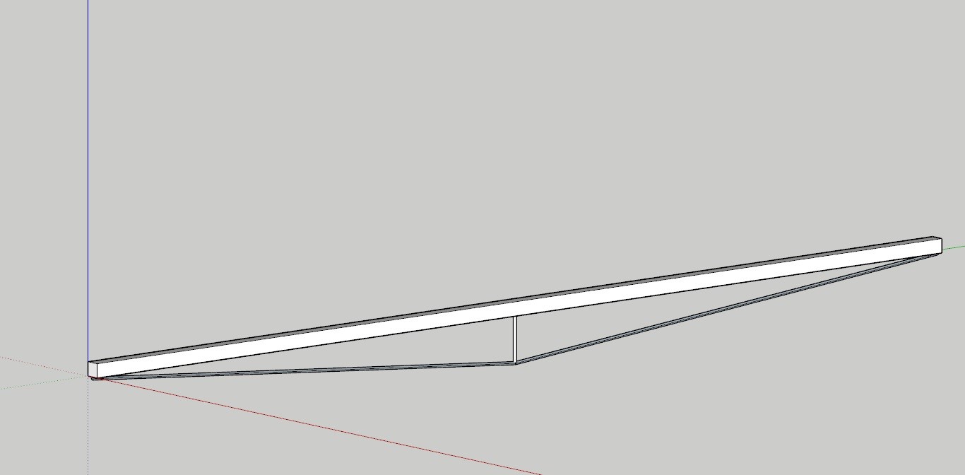

That cunning plan? All the ones I saw use rebar in tension to add stiffness as in the sketch below:
That’s 40x40x2 SHS 3m long. 8mm rebar at 5 deg angle. Calculating deflection for the two loads is beyond me.
Anyone got access to programs to do that?
