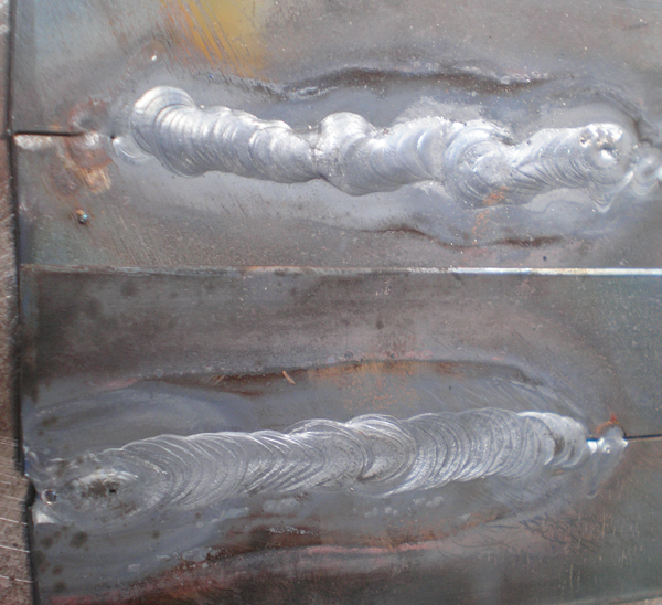

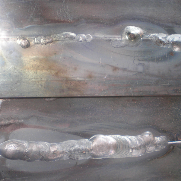

Hi,
While this is not my first TIG weld, It's my 4th. The other 3 were mess ups such as realising the gas was off, And that the tungsten should be negative.
Now I've got a proper bottle of gas I'm good to go.
I have ARC and MIG welded for years and recently got a few hours on gas welding which I think set me up for TIG.
I'd welcome comments on my first offical welds :
Picture 1 is the front. Picture 2 is the back.
Paraweld XTI121 Invertor. Lift Tig. 100Amps on the bottom weld, 80 on the top. 8 LPM. 2mm steel. 1.6mm Thorated tungsten, 1.6mm rod
