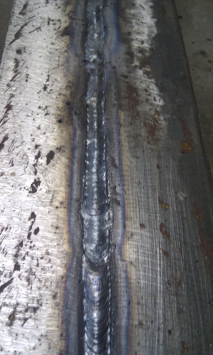

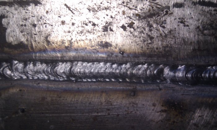

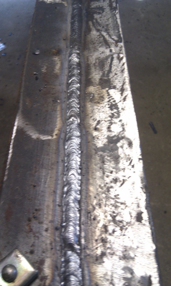

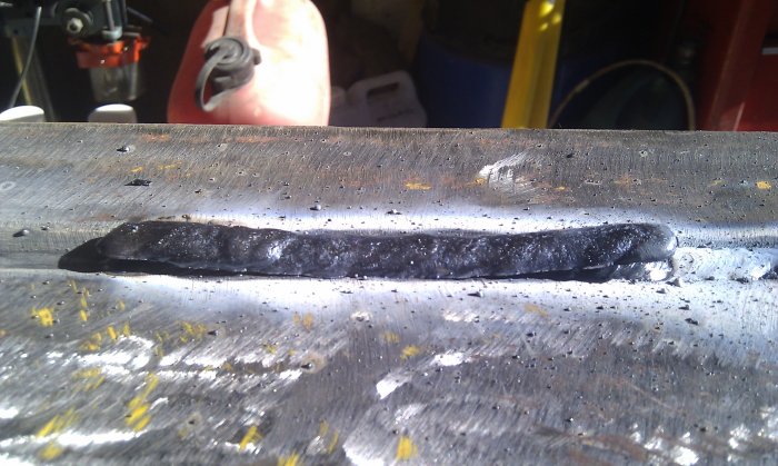

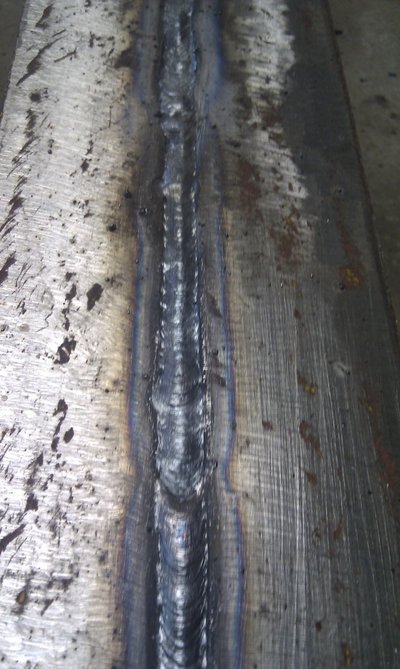

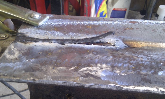

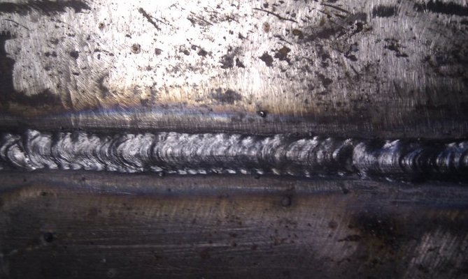

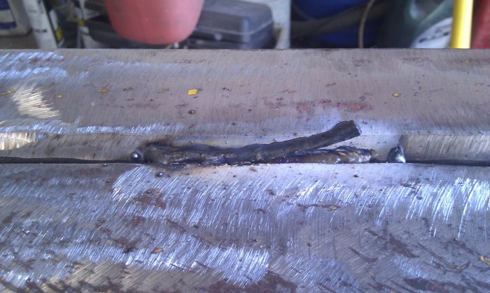

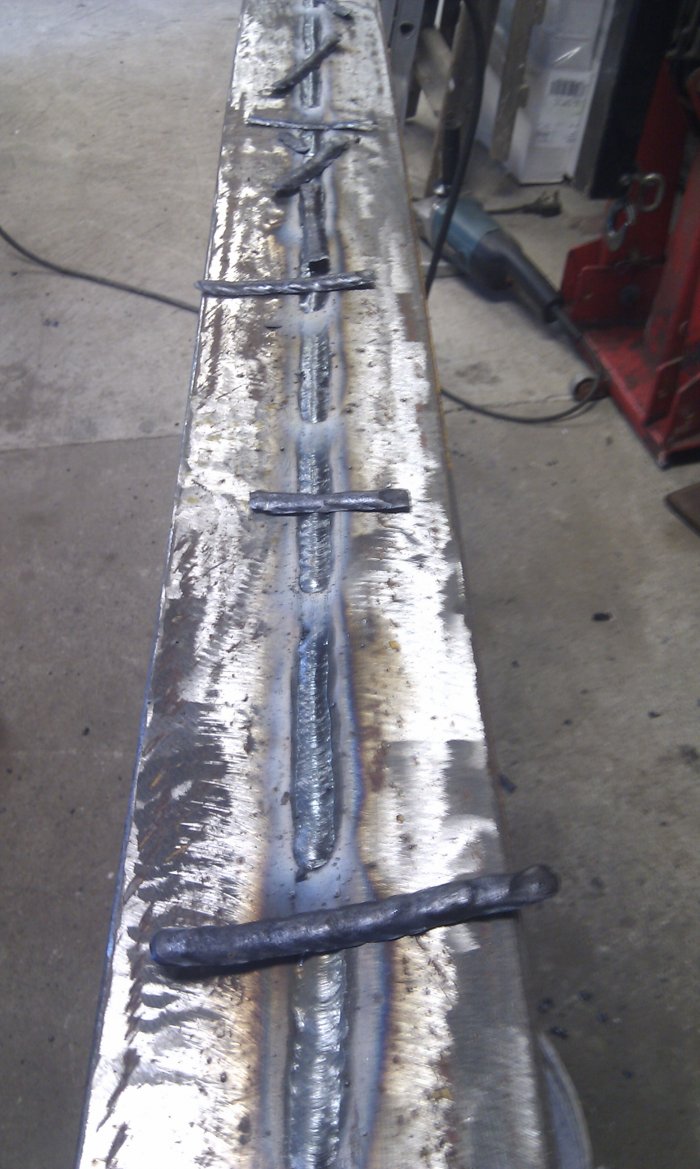

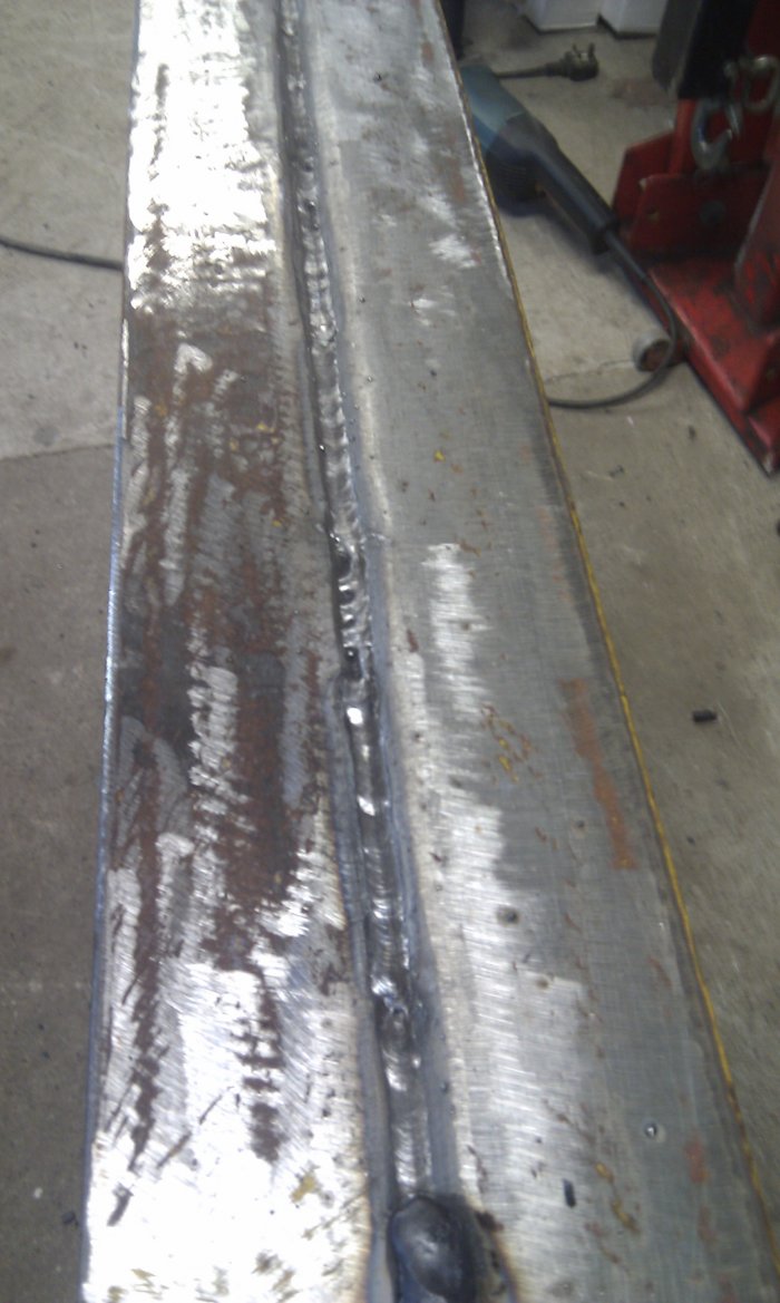

Here is something i started today, well yesterday anyhow. I just never got chance to post pics yesterday.
Its 2 c sections welded back to back. With a v prep and small root gap.
The first few welds are with a 2.5mm rod about 80 amps.
Then followed with 2 further runs over the top with a 4.0mm rod at about 190 amps.
I really cant fault the tec arc machine. It never overheated once. She was working hard to, i mean it took about 20 rods to do the cappping run.
Am pleased with the results
