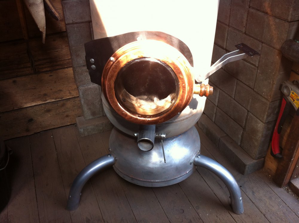

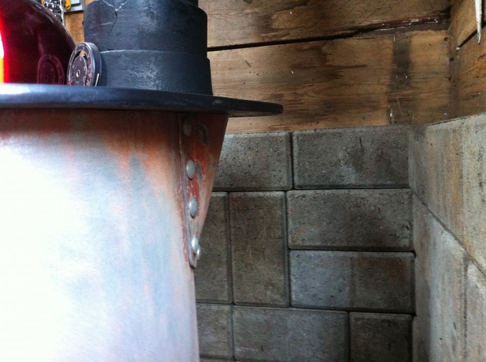

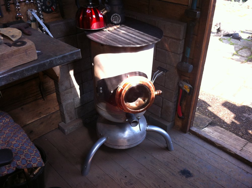

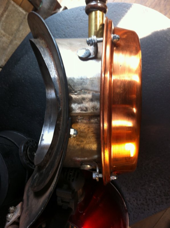

got given two propane bottles so made another stove(my second attempt)
....,much easier this time only took about 3 eve,s....,used an old copper pan with pyrex lid as viewing window..bit of scaffold pole with butterfly valve as air intake ..two staggered baffles inside..an old foot pump pedal as door handle..., main difference was i extended the rear of the cyl to get the flue right at the back so i could have a bigger top plate for kettle etc....used a lift off gate hinge pin with the sleeve from an old wishbone bush perfect fit..!cant decide whether to paint it or not....paint never seem,s to last very long...
