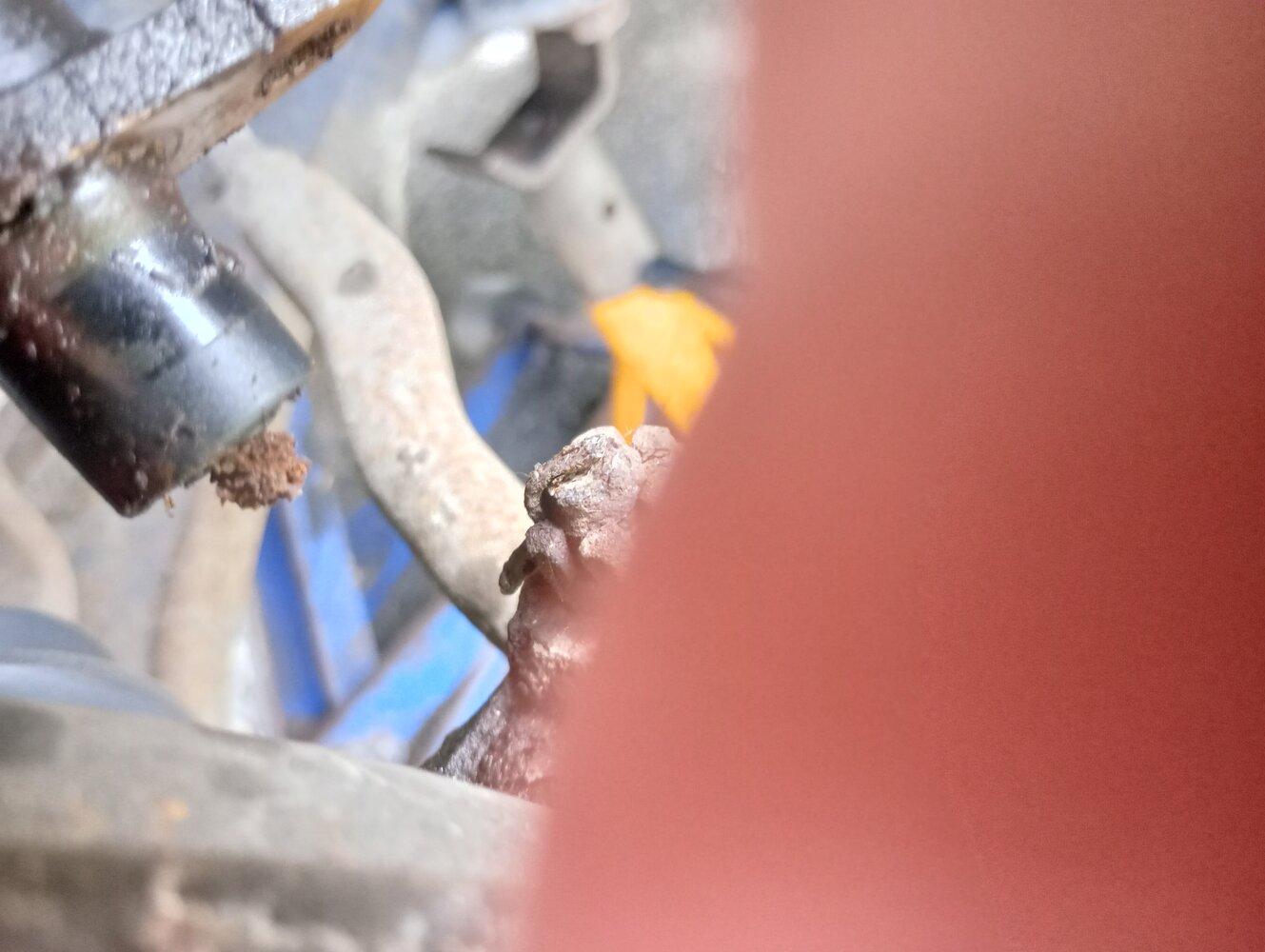

Got a new car for my daughter and we are running her old Yaris for now. Had the ABS pump buzzing at sub10 mph on gentle braking dry road. No codes. I've already changed both rear bearings which include the ABS sensors and rings. Look at the sensors when I got them out.
It's amazing the light stayed out.
