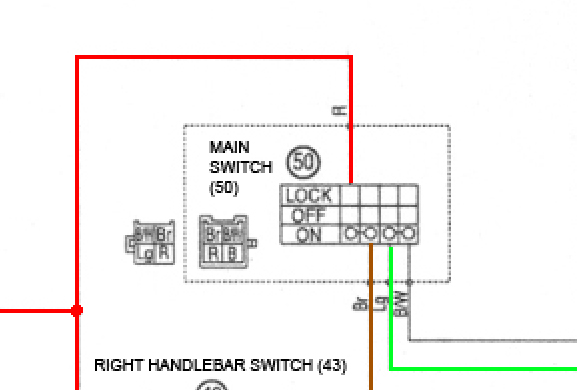

Hi guys, looking for some help to get this bike started...
It is cranking over but there is no spark at the plug. Its the fuel-injection model.
Did the obvious thing and put a brand new coil & plug on, still no spark.

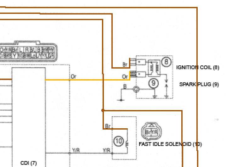

Out with the multimeter, I've discovered the orange cable going from CDI to ignition coil is grounded, isn't this orange cable suppose to be the +12v input for ignition coil?
I checked my other yamaha and the orange cable is not grounded on that bike although it is a carb model.
Any ideas please?
