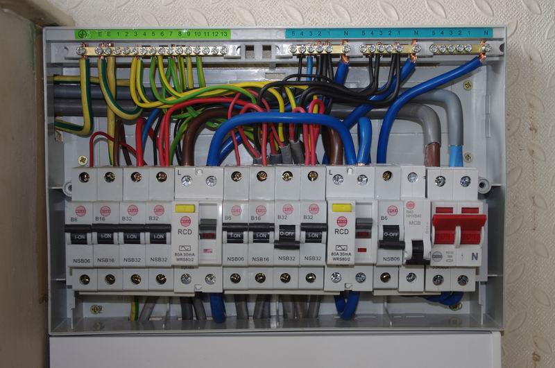

Hoping some one could help me out, im trying to source wylex 20a mcb, a type c and d. I am not an electrician so did not kniw about differant types etc, I googled what I wanted and brought some, turns out I ordered a psb type, these do not fit my bus bar, psb has a hole type fixing were as all my others have a slot, afer research it turns out I need a nsb type, I spoke to eleconline which is were I got thenew ones from and they said I need the older type which they can order from wylex at £20 each, new ones were £5 each,
