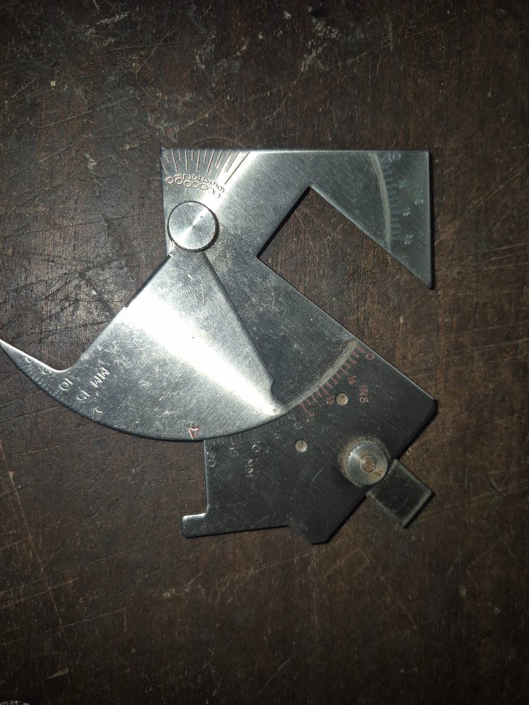

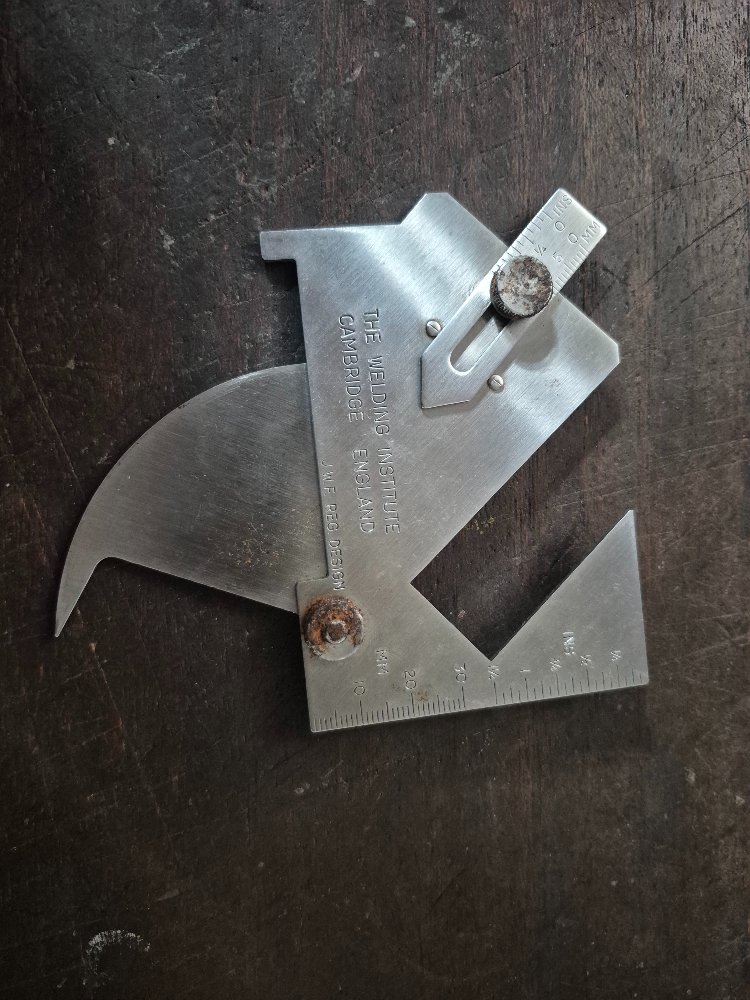

J jimbo1962 Member Messages 87 Location Ireland Yesterday at 8:12 AM #1 A friend who deals in old tools for developing countries showed me this gauge. Ive never seen one before. What s it for, anyone ? 20260513_080837.jpg 169.7 KB · Views: 35 20260513_080816.jpg 154.3 KB · Views: 33

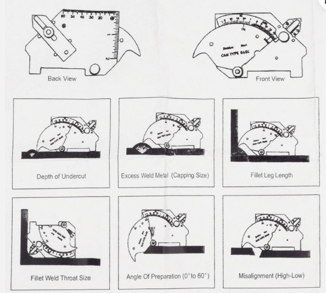

dieselsamurai Too many projects not enough time! Messages 1,738 Location Hampshire Yesterday at 8:16 AM #2 here you go
dieselsamurai Too many projects not enough time! Messages 1,738 Location Hampshire Yesterday at 8:20 AM #3 Cromwell sell them but Temu or Ebay is a tenth of the cost https://www.cromwell.co.uk/shop/welding-brazing-and-soldering/accessory-kits/mastergage-cam-type-weld-gauge/p/CTL8855410A
