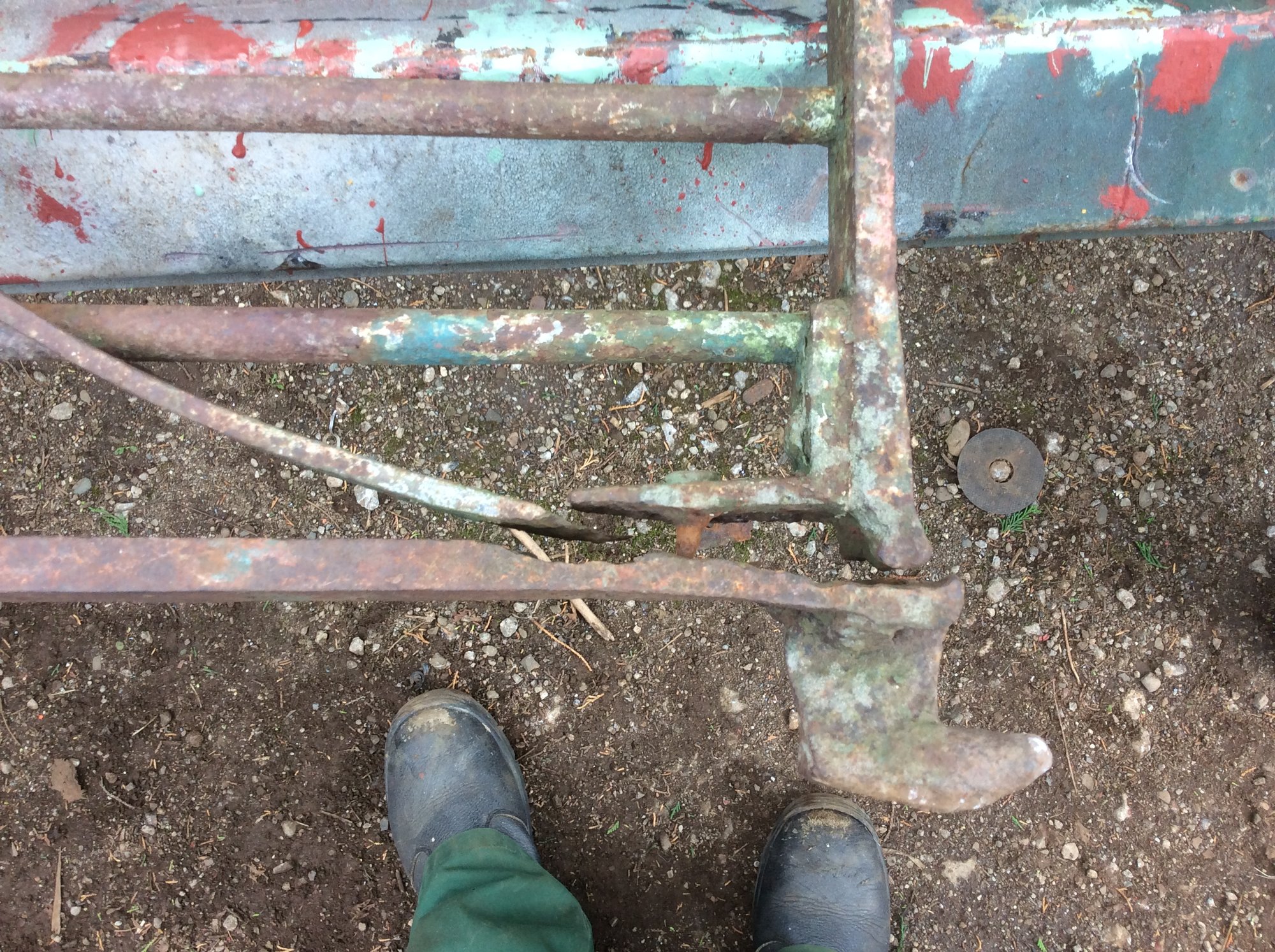

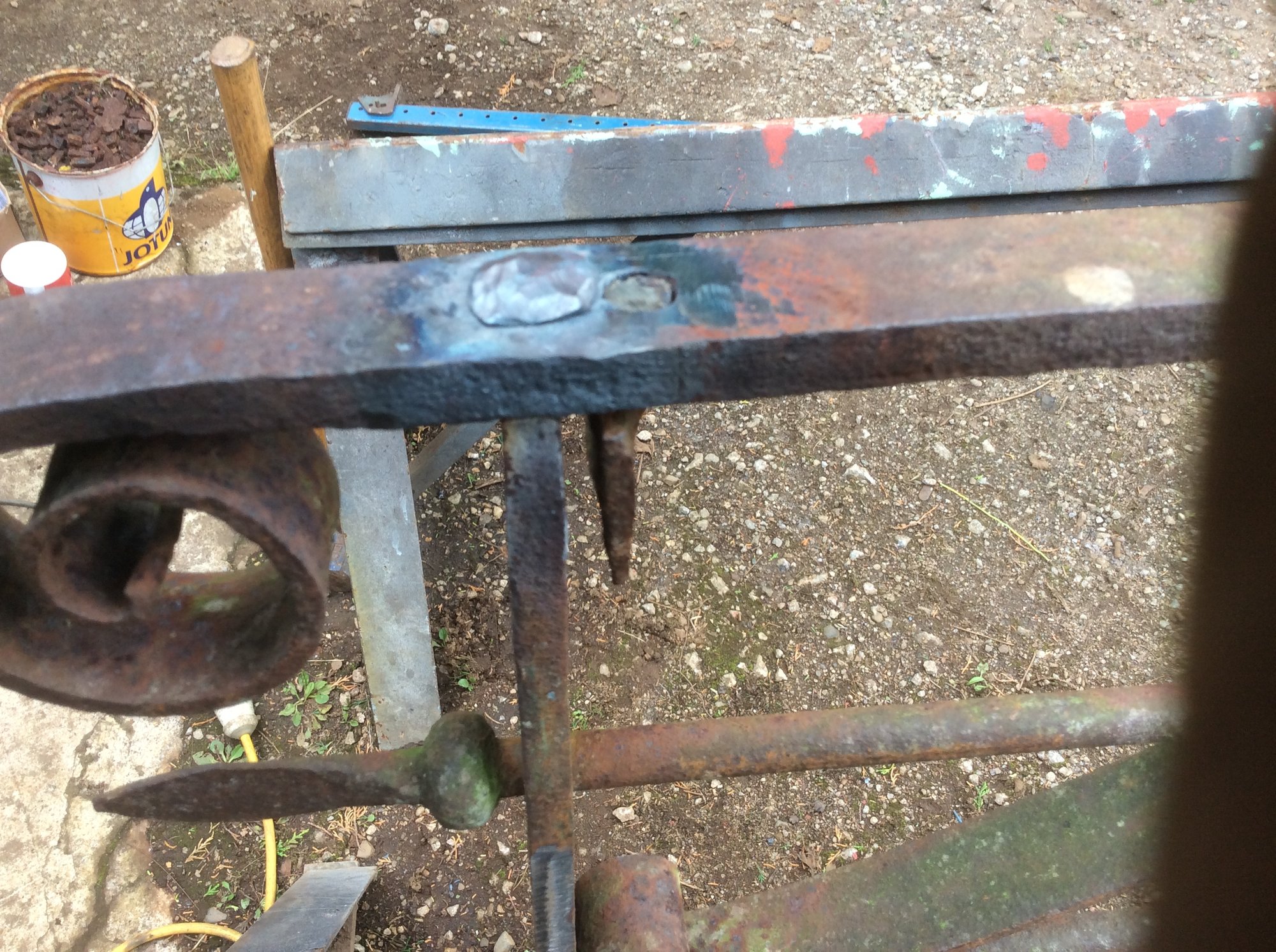

View attachment 248359 View attachment 248360 Now the joint of the bottom pin to stile has separated ,so I’ll have to cut the excess off the bottom rail,which will allow the scroll to re join,I cant jerk it in over the rail as that will put it out of square,this must have been buried to rot like that.
Not surprised at the wear on the latch,gate comes from a house which was a pub....100 years ago.
