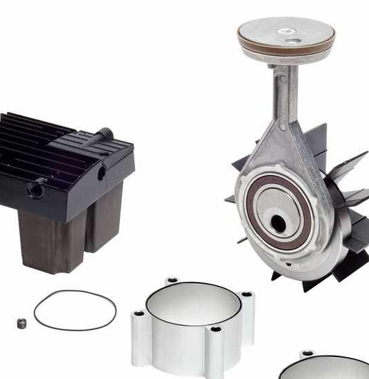

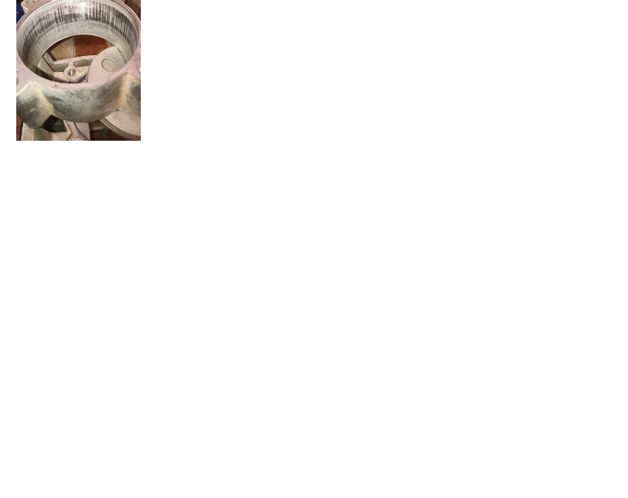

Had a punt on a Jun Air compressor sold on the bay of thieves as for "for parts not working". Its a rocking piston oil-less design, and was pretty high spec as new. On quick inspection both cylinders are foobared with scoring and wear, and the (PTFE?) rings are toast.
It appears that you cant buy a cylinder and ring kit for it - the closest kit includes the rod, bearing piston, heads etc.. and to do both cylinders they want £800 - £1000, which is a non starter for a £20 ebay punt.
So im looking at other homebrew ways to fix it - I have 2 main issues: 1 - recovering the aluminium cylinders and 2 - where to get new PTFE ring/seals from.
1 - the bores/cylinders, fairly simple design, aluminium, symmetrical in all senses, 80mm diameter - don't know if they would have had a surface coating (thinking nikasil (sp?) or similar)
The non running zones look like someone may have honed them lightly - possibly as an attempted fix - I would think such a bore should be a smooth finish with PTFE running surfaces?
Anyone suggest a way of rejuvenating them - I was thinking of someone like Poeton who have various bore coating/repair - often aimed at 2 stroke racers, though no idea on cost or how much material they can build up.
2 - the ring- well it's not really a ring as the piston splits in half via a bolt through the crown so it's more of a disc, any ideas where I can get one - or one made - the piston is a lot smaller than the cylinder so it's not acting like a conventional ring.
From the service kit picture perhaps rings have previously been fitted the wrong way up, torx bolts in the tops of the pistons had definatley been pre-chewed by someone.?:
I like a challenge but this may be a basket case - let me know what you think....
