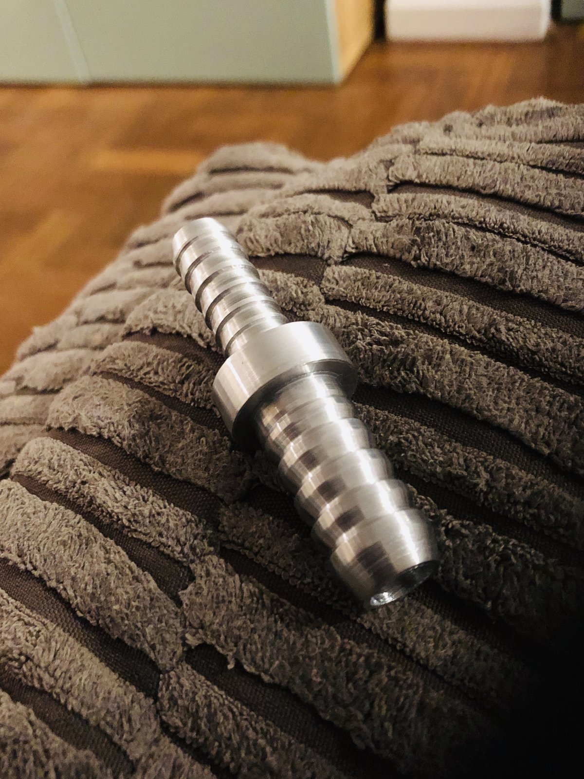

If that’s any use to you then you can have it. If not I’ll chop it in half and use them as weld on tank fittings so no loss to me either way.

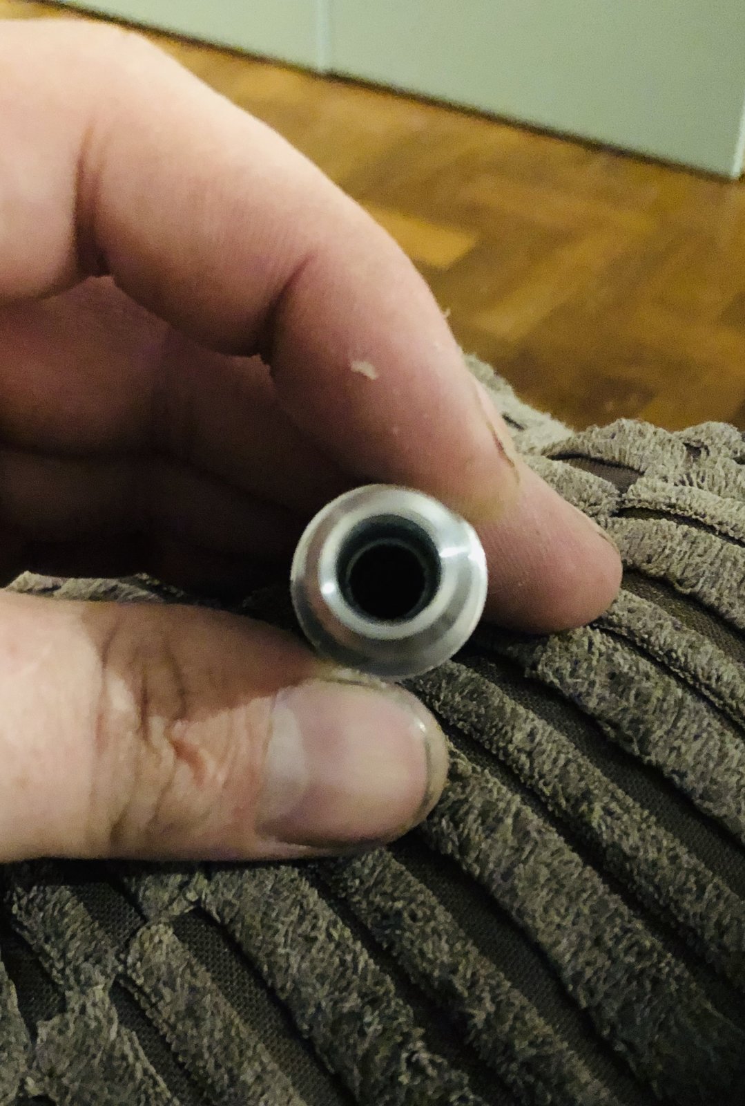

Just over 13 and 10 on the OD
8.5 and 7 on the ID so a 0.75mm step in the middle which isn’t gonna cause any problems I don’t think. If you want to bore it out further then you can easily enough.
It’s not a high tolerance part as it was done in 20mins on the 3 jaw.
Plenty good enough for joining 2 dissimilar pipes mind.
