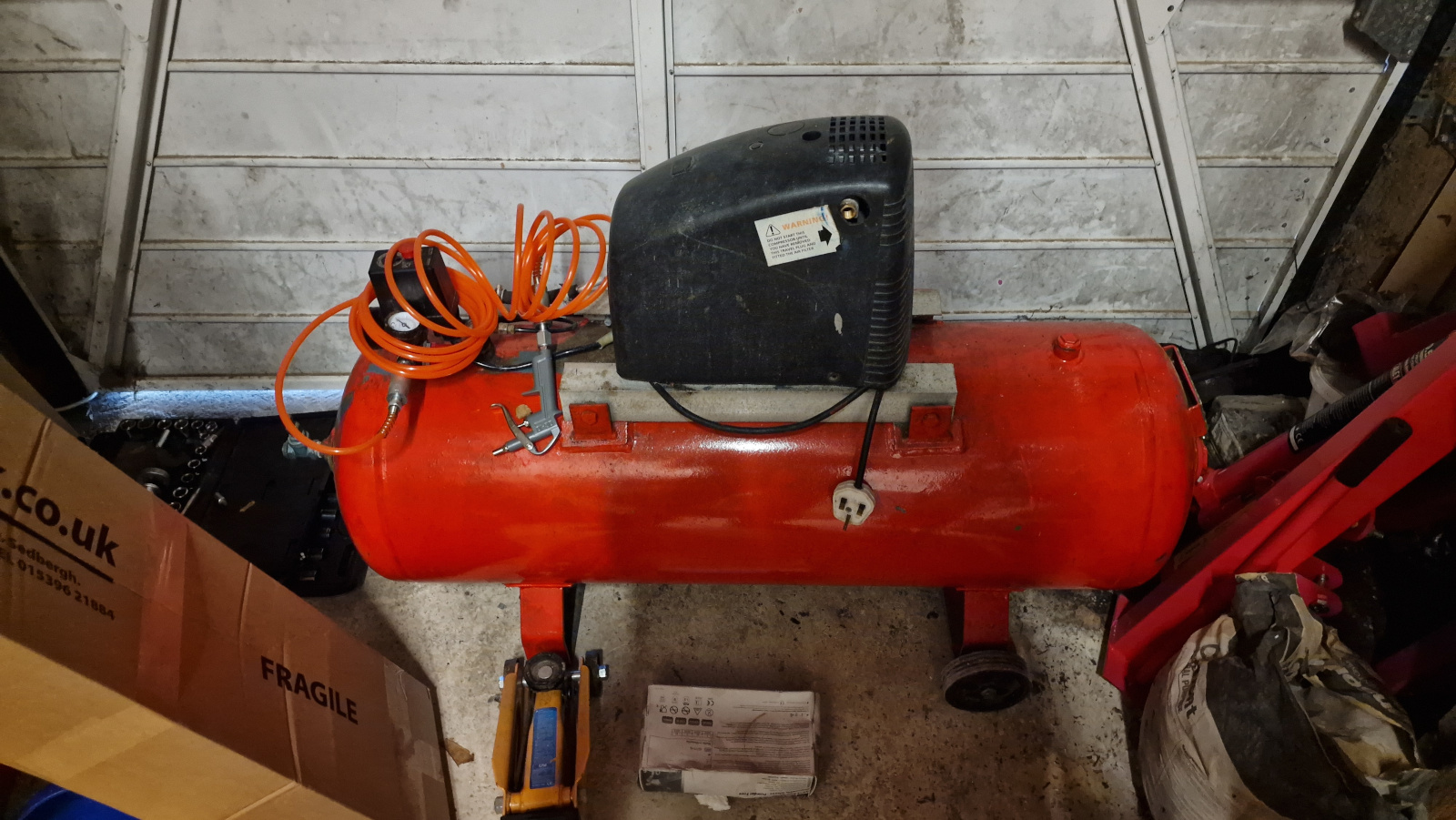

I picked this up from a Facebook seller a while back and would like to stand it up as it takes up a bit of space:

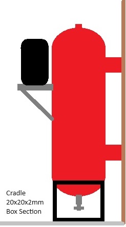

My plan is to make a cradle to sit the receiver in, take the wheels off to bolt it to the wall and spin the compressor so it is the correct way up like this:
I will probably put some cross bars in the cradle for strength, apart from that can anyone see any issues with doing this?
