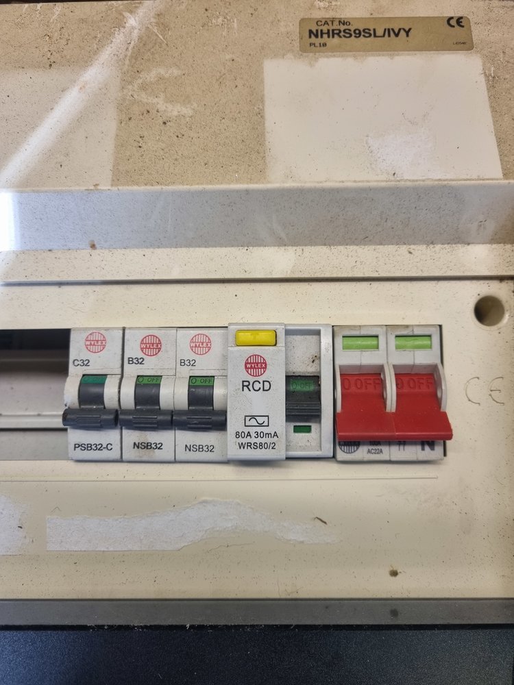

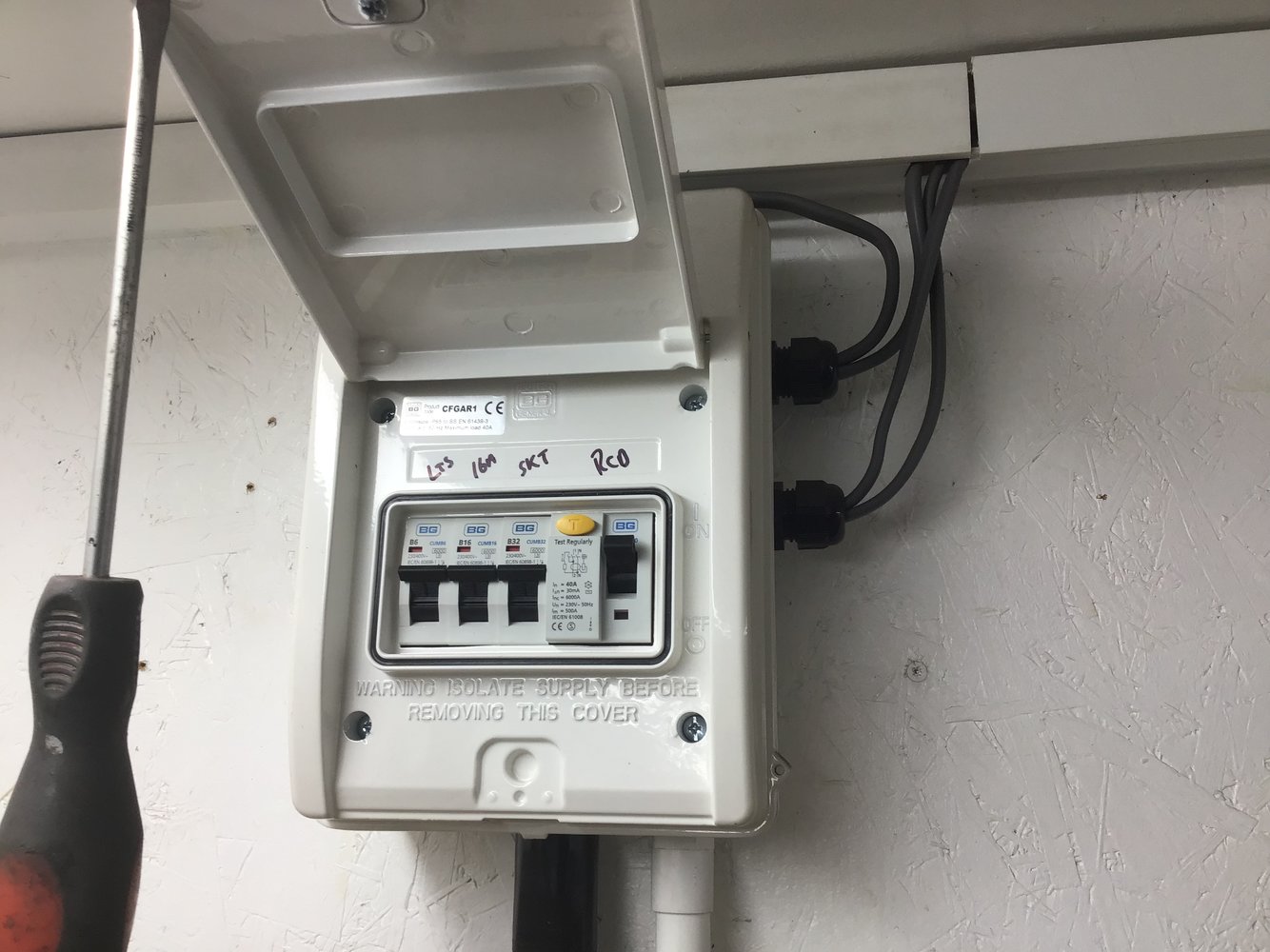

rather all pointless if its through a 30ma rcd in the house db if thats where its fed fromWhip the front cover off of that cu you have there and show us a photo.
You could likely keep it and ditch the RCD in it at the mo. Then I maybe give you a C6 RCBO for the lights, a B32 RCBO for the sockets, B32 RCBO for the plasma & welder. You could have the C40 RCBO for the compressor.
You need to know how your existing set up is fed from the house cu.
