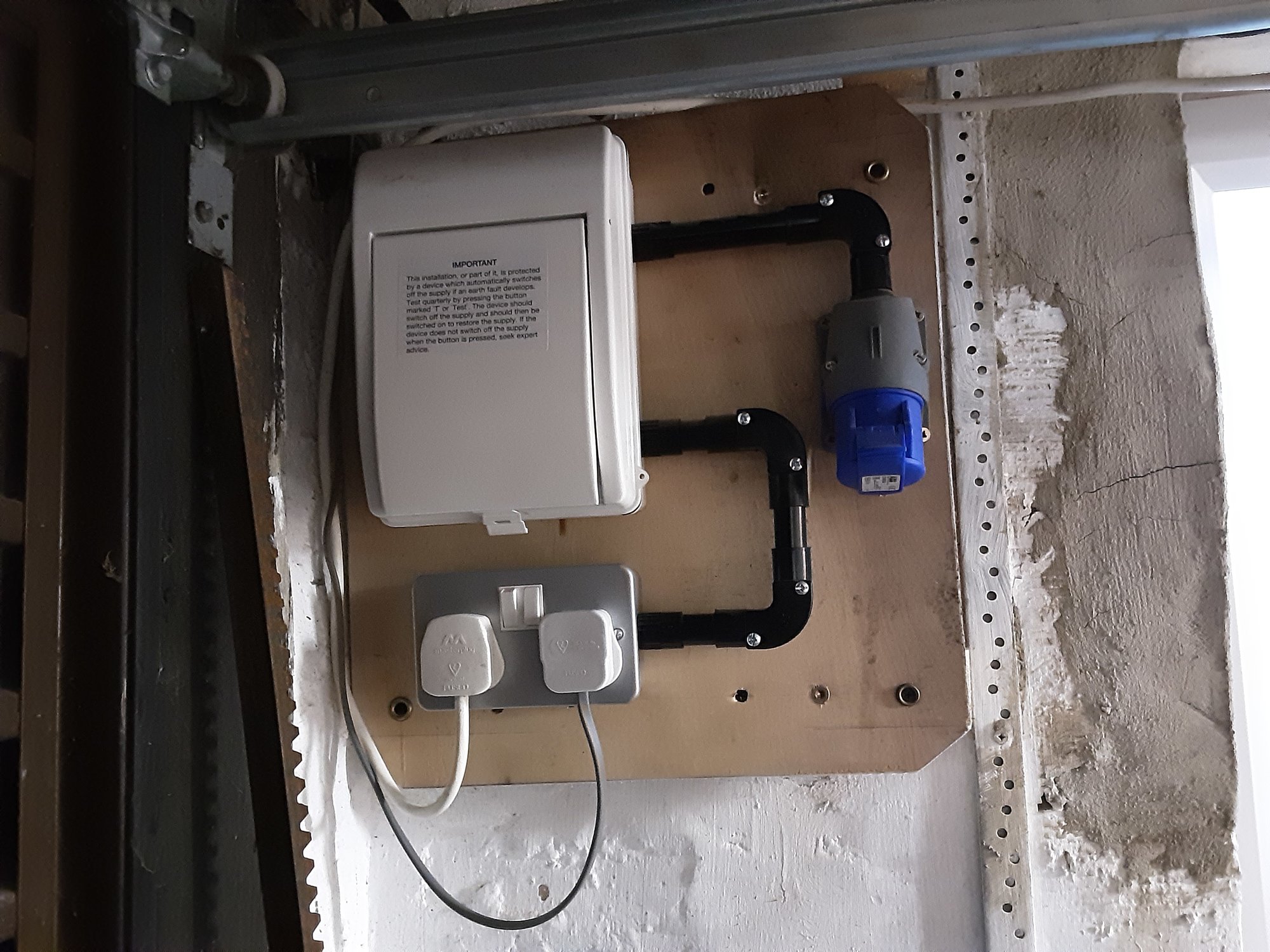

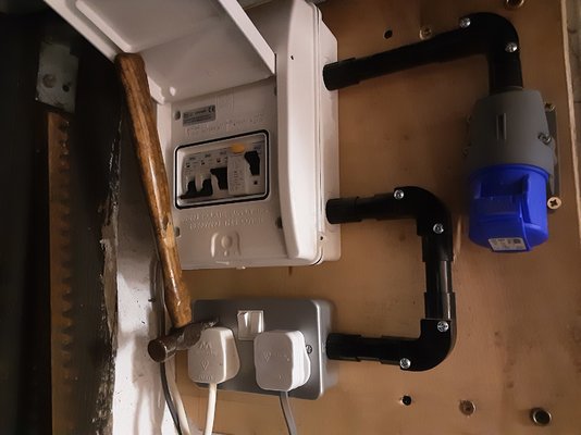

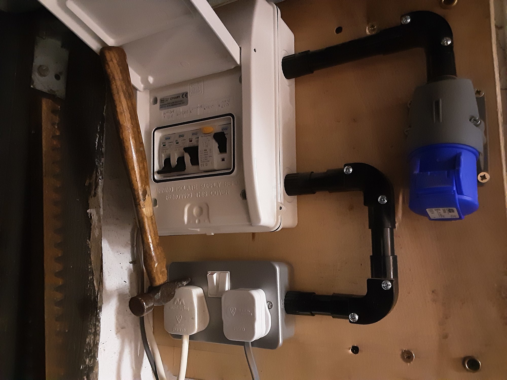

Have recently changed the desperately dodgy antique fusebox in the mancave for this:
As per this shot:
...there's 3 breakers, 32 amp for the welders, 16 amp for the mains sockets, and 6 amp for lighting. Ignoring what's currently wired in, which is temporary, my intention is to run a ring main of 6 double sockets, which is no bother for me to fit, but the lighting has me scratching my head
At present there's three 8W LED lamps in the roof for general lighting, wired in parallel with 1mm t&e flat cable into a standard 13 amp plug. This is temporary just to give me some working lights. There's also a pair of 3' LED lamps above my main bench, again wired temporarily to a plug and into a socket, and I want to fit another 2 of the same above my other benches.

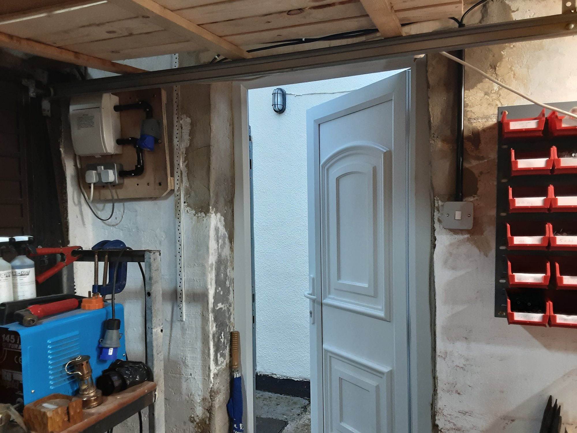

I'd like to have the roof lamps wired to the metal switch to the right of the door, as per this shot:
...and the existing pair of 3' lamps to another similar switch, and the "to be fitted" 3' lamps wired individually to separate switches.
Question: What's the best/simplest/safest way of wiring them in, bearing in mind they'll all be switched separately and the switches will be at either end of the 'cave?
Much thanks in advance.
