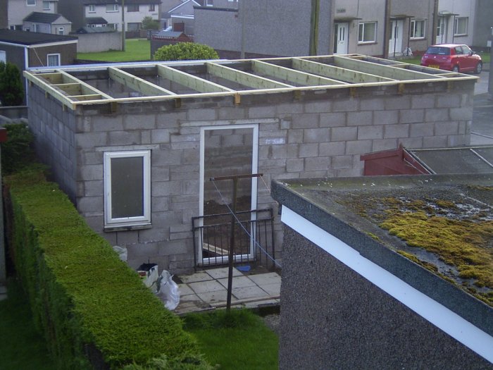

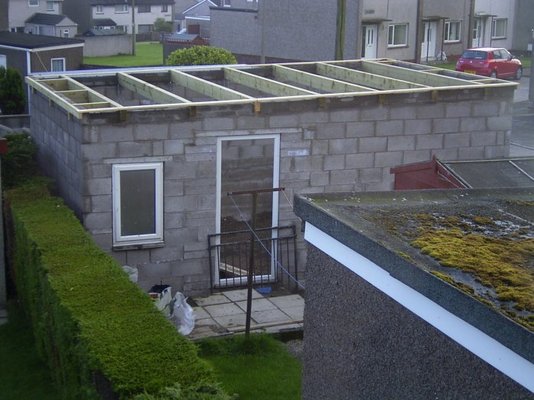

I'd be very grateful if some oy you more knowledgable builder types could advise me on my workshop roof.
As it stands currently it is almost a flat roof, it actually has a slope but it's only shallow (5 degrees) over a 4.6M (15') width. It's been fine for nearly ten years apart from a little sagging, until a couple of weeks ago when it started to leak quite badly. The water is coming through the tar felt and seeping straight through the osb boards underneath.
So, I'm planning on taking the roof off and replacing it with box profile metal roofing sheets. I've been in touch with the supplier and he has told me to put the joists on 16" centres. The workshop is 8M long so I will need 20.
The question is what size timber should I use for the 4.6M span?
It currently has 4x2 and it has sagged slightly over the years, should I go to 6x2 or even 8x2?
