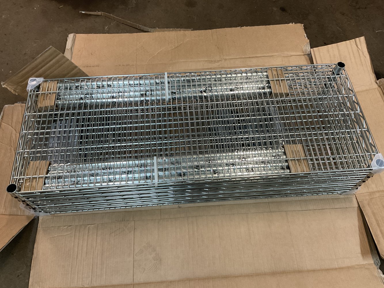

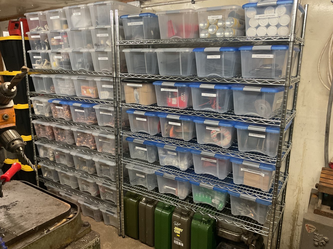

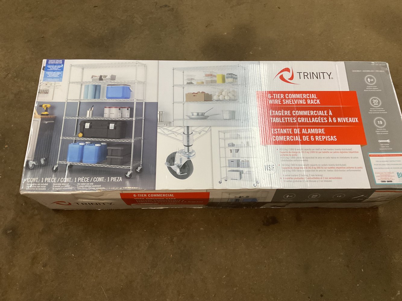

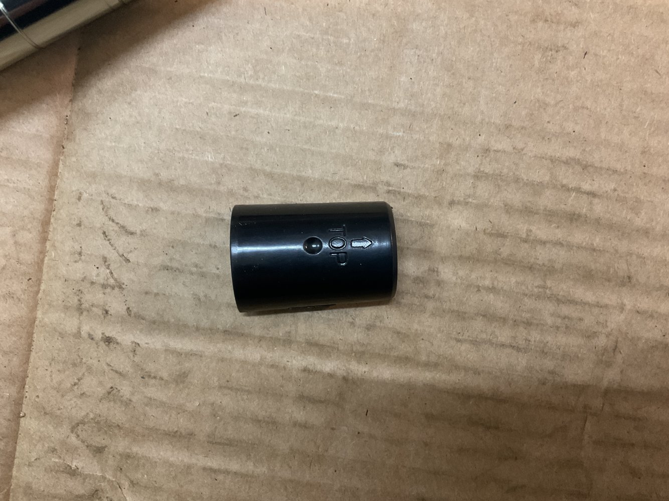

A bit of a shoutout for Costco’s racking, wasn’t really expecting much because it was cheap. Turns out it’s pretty sturdy,I don’t think you could buy the materials and cobble something together for same money.

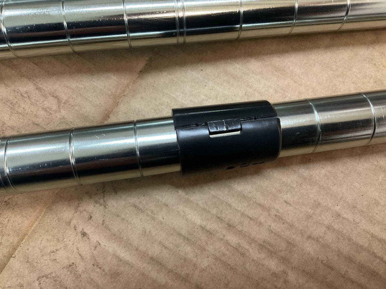

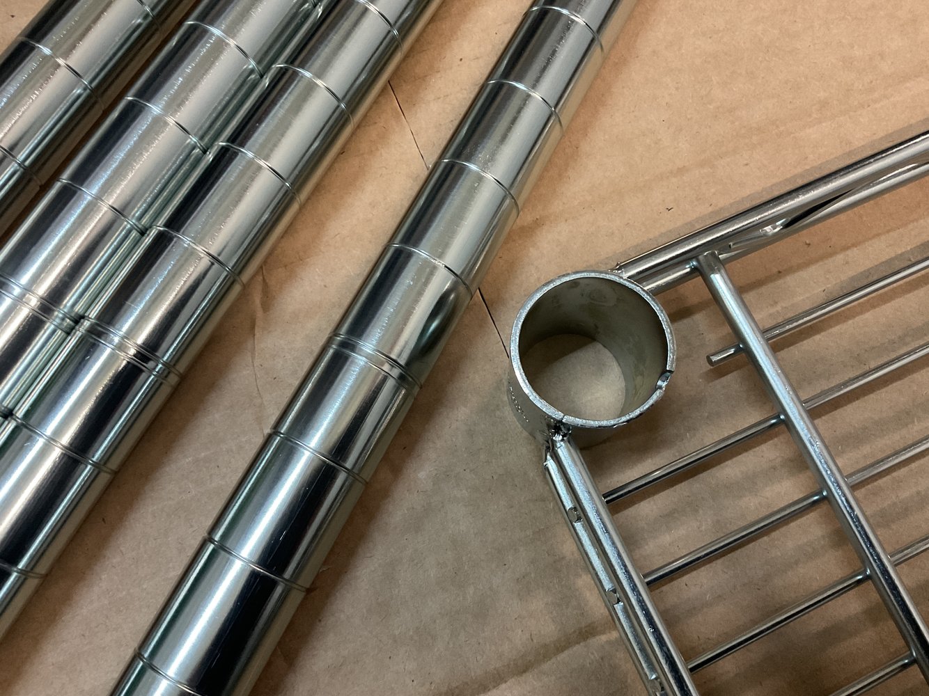

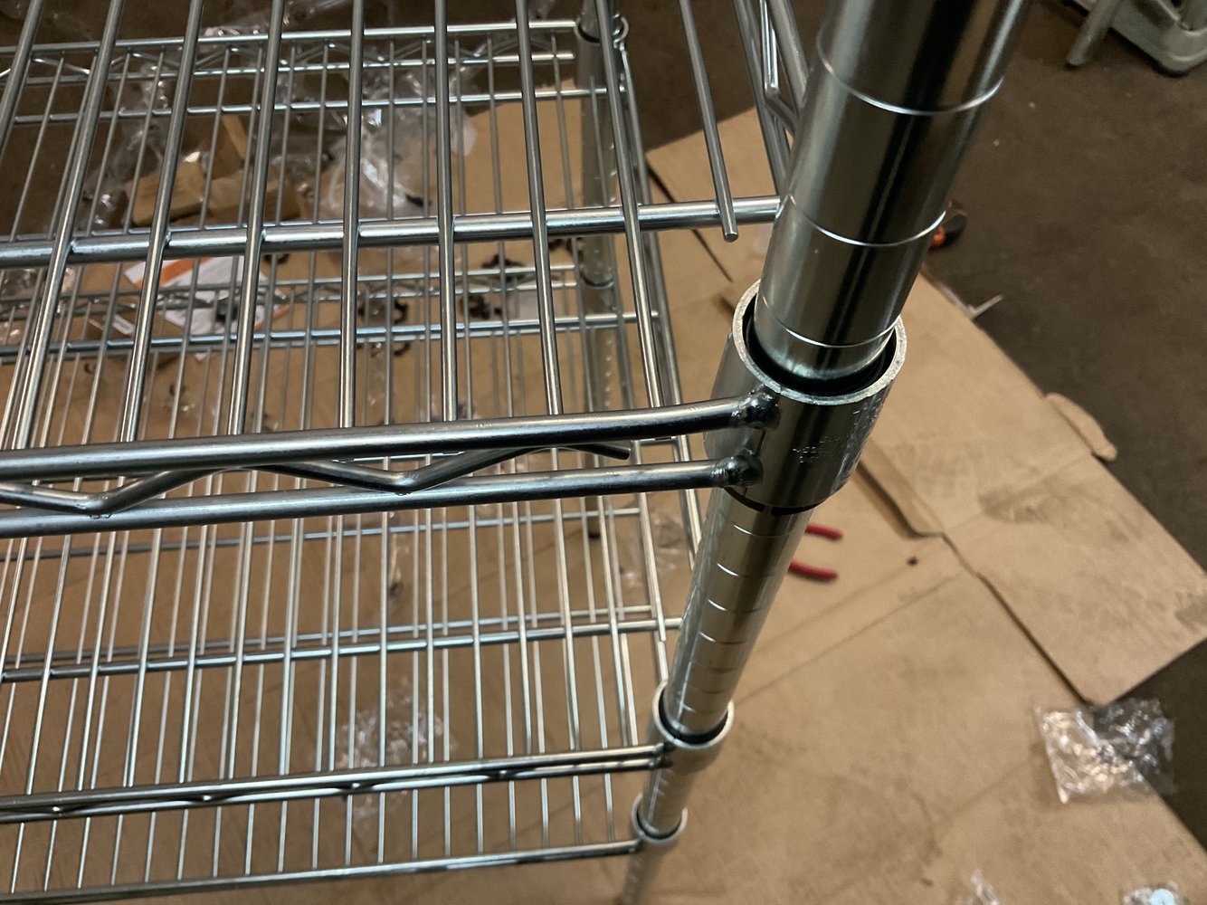

Uses a taper collet system to lock in the grooves of the uprights, just needs a gentle tap with a rubber mallet to bed the shelves down.
Shelves have the matching taper.
Comes with castors or you can use the adjustable feet.
