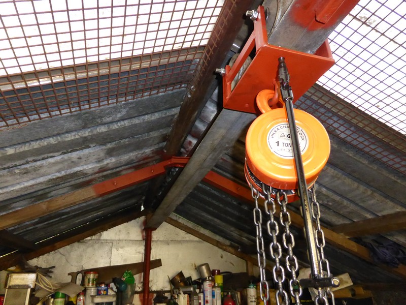

Hi Folks,
Planning to make a workshop at some point, we've an old pole barn/shed that's becoming redundant so I'm having the space, will be able to fit a 35' x 18' (one 15' bay and one 20' bay) steel frame in there, I'm thinking 9/10' to the eaves, but I was wanting an overhead girder track for a chain block, can I run this from drop-down plates hung from the apex of the frames, obviously the steel will need to be strong enough but I'm only talking of a max 1ton hoist as I won't be able to fit anything big in there at only 10' eaves.
If this isn't possible I had thought of having two hanging from the middle posts of the building that would meet in the middle somehow to allow use of one block that would slide over from one to the other, this would cover most of the floor of the building provided I put them in the right spot.
Any comments or recommendations?
