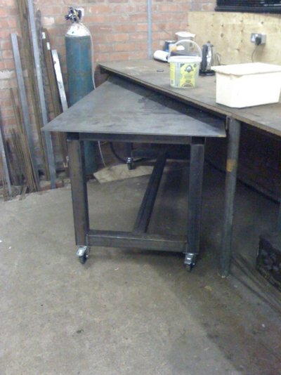

So, I'm going to make a new, smaller one that will be on castors and will fit neatly under the current bench. I've spoken to my steel supplier and, most fortuitously, he had some 80x80x3 SHS returned to him in 9' lengths earlier in the week so I've taken eight of them off his hands for a tenner a piece. They should make a good frame.
I've also got a price for 6, 8 and 10mm plate off him (£71, £94, £117 ex. VAT). Problem is, I can't find a definitive answer as to what thickness to go for. OK, well I'm not expecting someone to say 'it must be this thickness' but I should've thought there're a few people here who've built them and I was wondering what the general concensus on min. thickness is. Personally, I think 6mm is cutting it a bit fine so that leaves a choice of 8 or 10mm. Any ideas?
