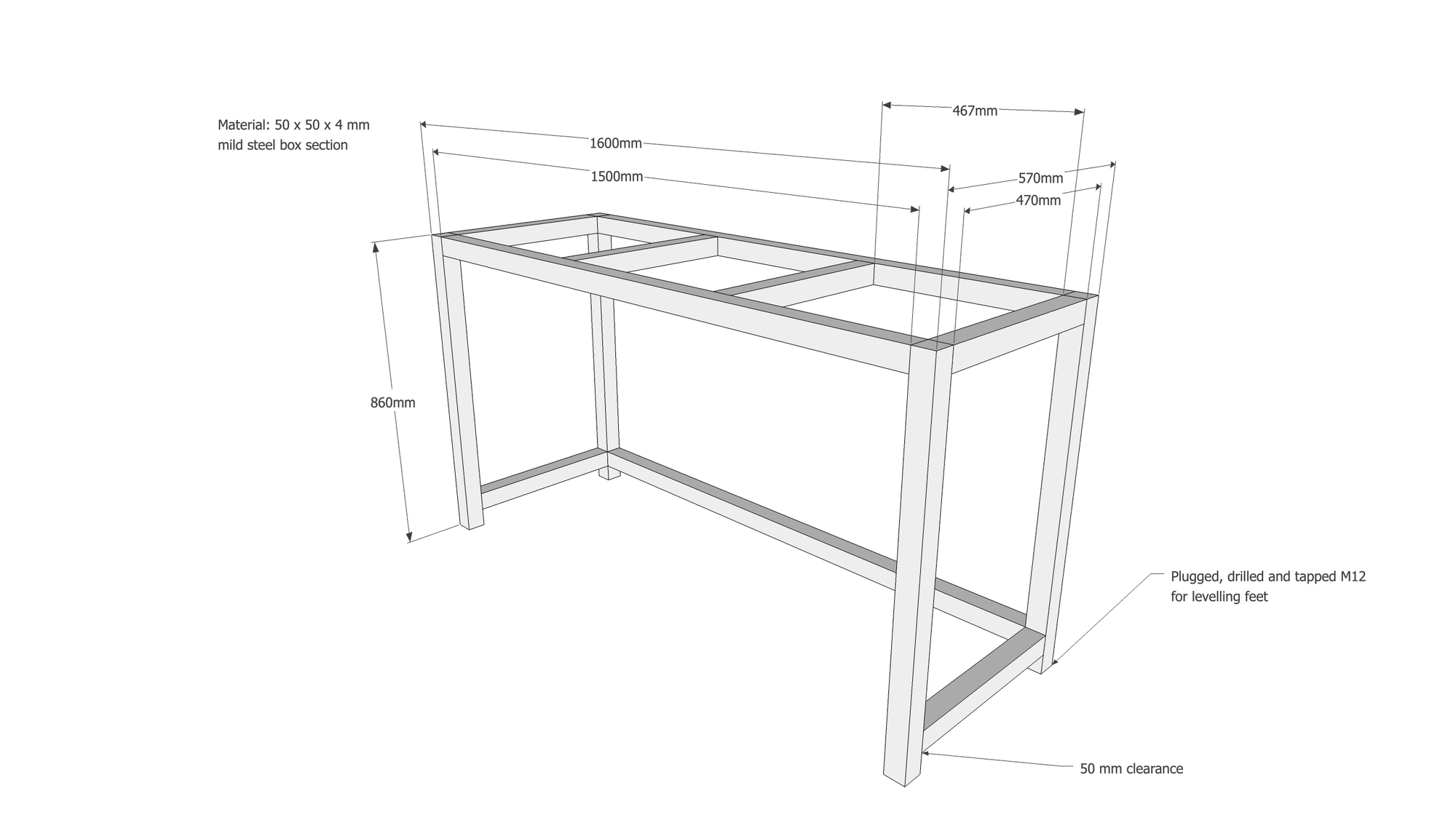

Hi folks,
I'd appreciate some advice on the workbench design attached please. It's for my home garage workshop. I'm planning to put a wooden worktop on it for now, but I may replace that with steel plate in the future if I need a welding table. Alternatively it may end up with a bench top lathe on it at some point (~200 kg). To maximise space, I'd like to have the option of putting a small roller cabinet underneath it.
Stuart
- Is 50 x 50 x 4 mm box section overdoing it?
- Would it be better to use 50 x 100 mm box section for the top parts?
- Any other tips would be very much appreciated!
Stuart
