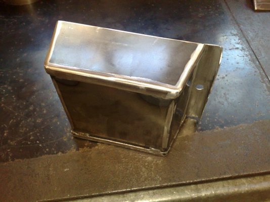

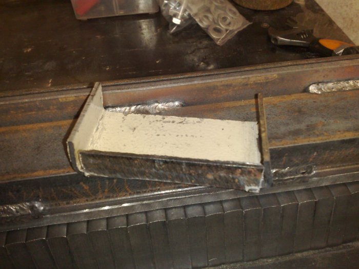

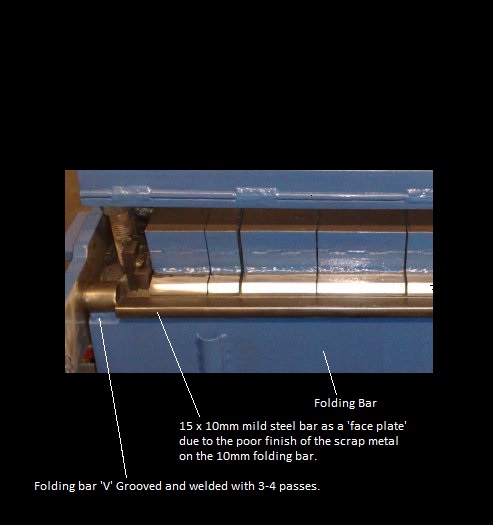

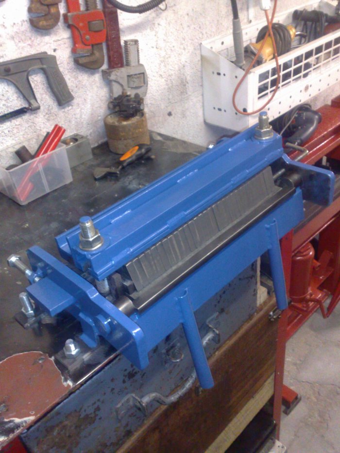

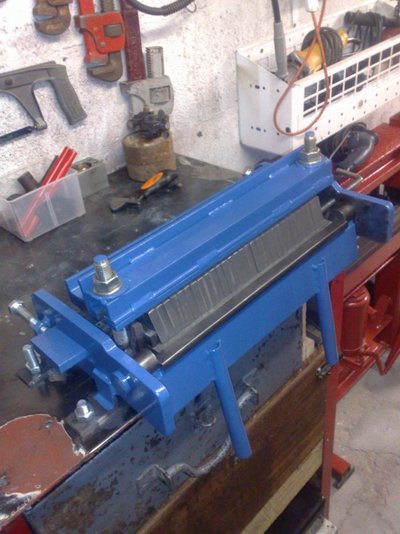

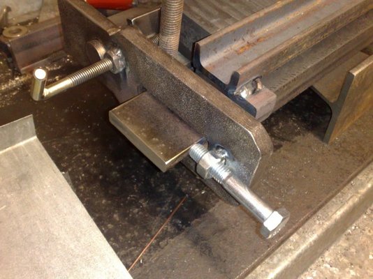

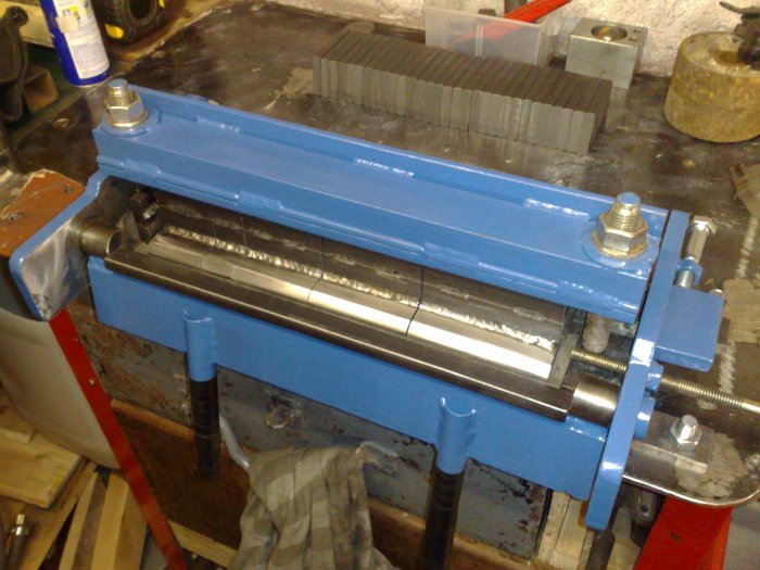

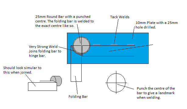

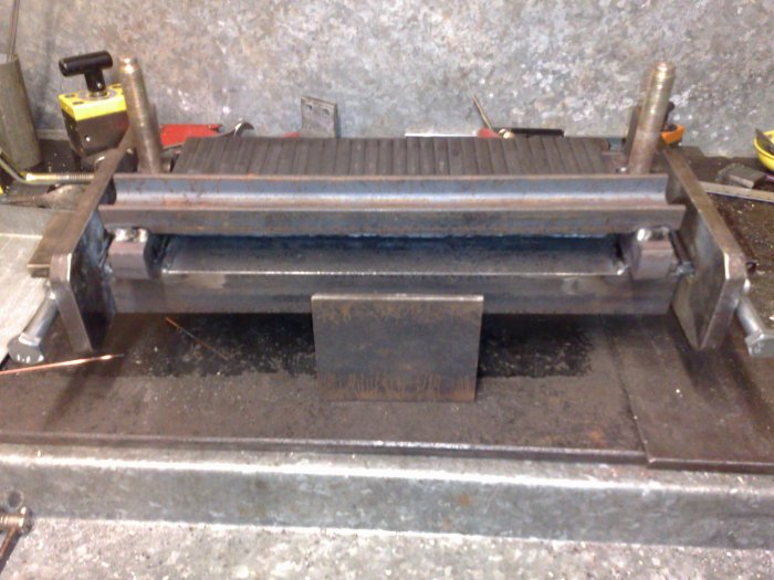

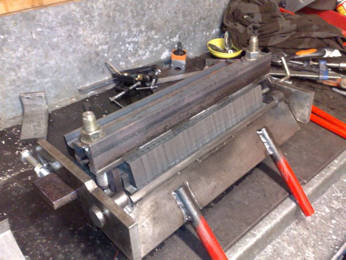

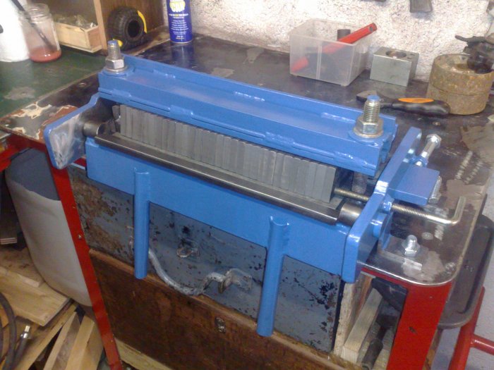

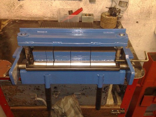

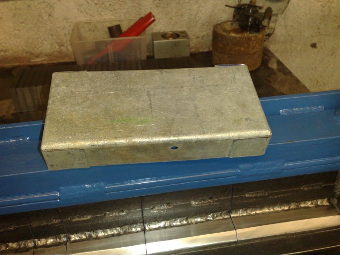

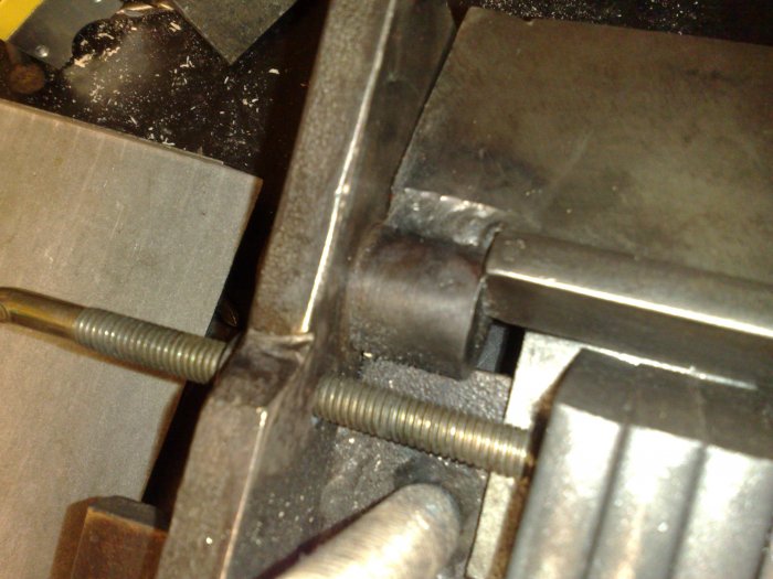

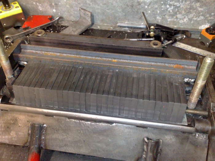

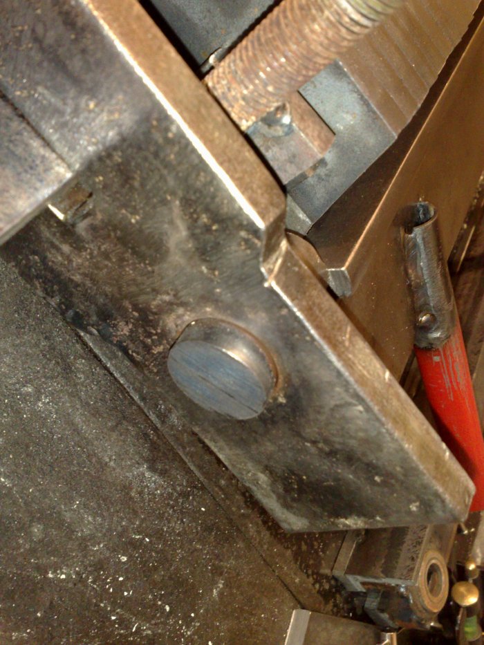

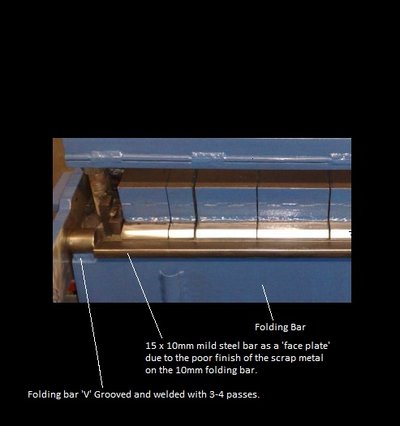

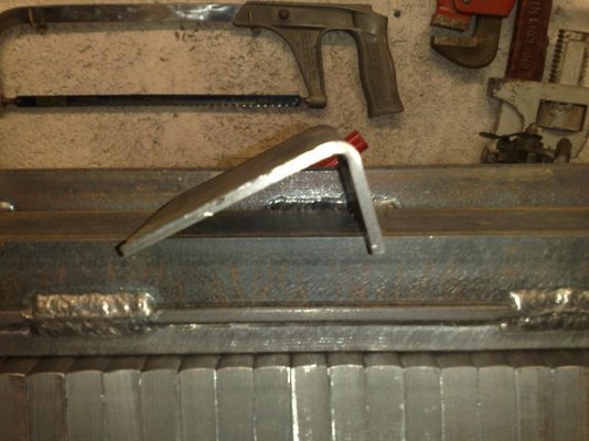

Hi all, this was my weekend project.
I've wanted a small heavy duty metal folder for a while. As you have probably seen I made a 30 ton hydraulic one last year, but it is not great for tight angles less than 90 Deg. I have considered buying one but most can only bend around 1mm
I have recently been looking at 'welderpaul's' but I wanted one you could box sides as well. The only problem is money...!
So I went through the scrap bin and made this out of some off cuts and an old over engineered gate latch.
It's not quite finished, as it needs mounting to a bench and painting. Also I have some ideas for some different tooling options which can replace the 40x10mm bars.
