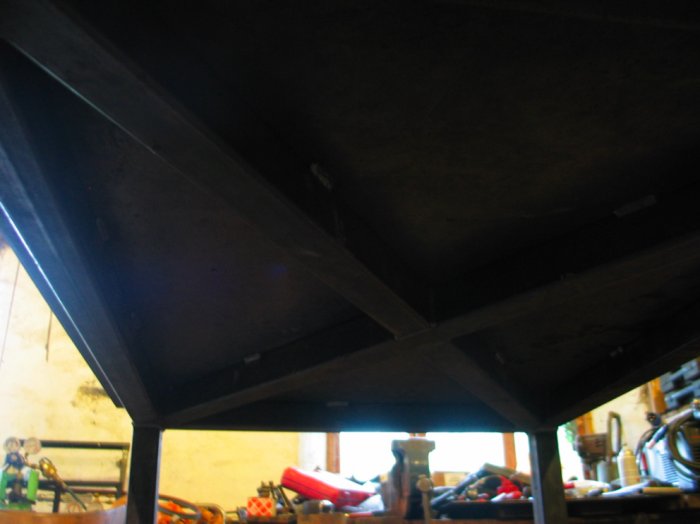

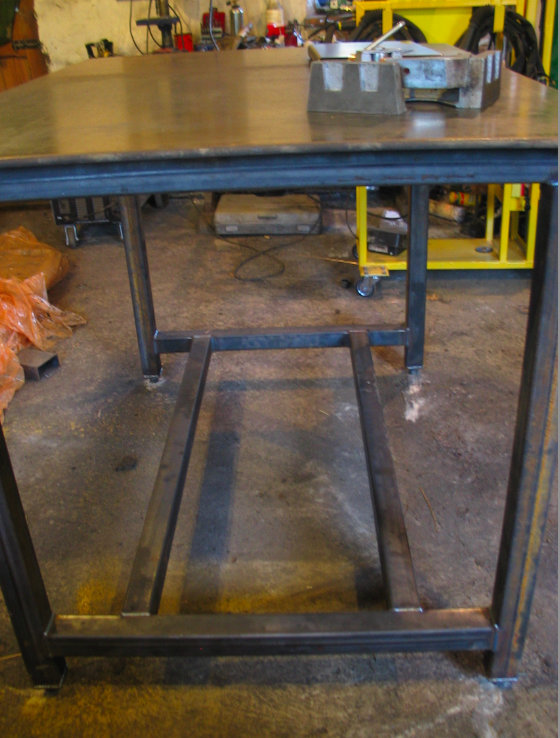

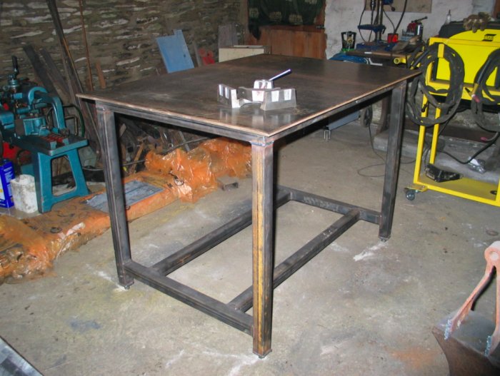

I built my first proper welding bench a couple of days ago, thought i'd upload a few photos
it's about 3ft x 4ft not quite though it's something metric just over 4 ft just under 3 ft
10mm surface, 50x50x2.5mm box frame, weighs about 150kg, was pretty hard turning it over by my self i can tell you haha
