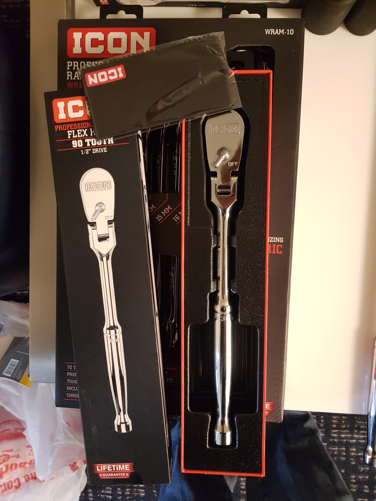

I bought a Halfords swivel ratchet & it was a pain to use as there was no resistance on the swivel, so I drilled down in the handle & put a ball & spring in, thin drilled 3 indents into the other part. I know I invalidated the guarantee, but it’s now usable.Those ratchet handles look to have “a positive click” in the swivel - a great improvement over the probably mega bucks S*** - O* ones that go floppy ( flaccid ?) and won’t stay put for insertion.
