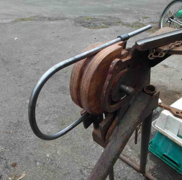

I wanted a flattened 3-3/8" centerline radius tube bender die, for 1/2" tube.
The tube is a mudguard stay and it follows the profile of the mudguard pretty closely[hence flattened], I am told you can spot repros cos they don't fit.
I did think about making a metal die, if it had been a round die[lot's of use] I might have.
I glued 4 scraps of plywood together and bandsawed the chunk of wood to the centerline radius of the curve. I routed the grove for the tube.
It worked great, the tube fit's perfectly. No idea how big you can go with wooden dies, but very useful to know this works.
