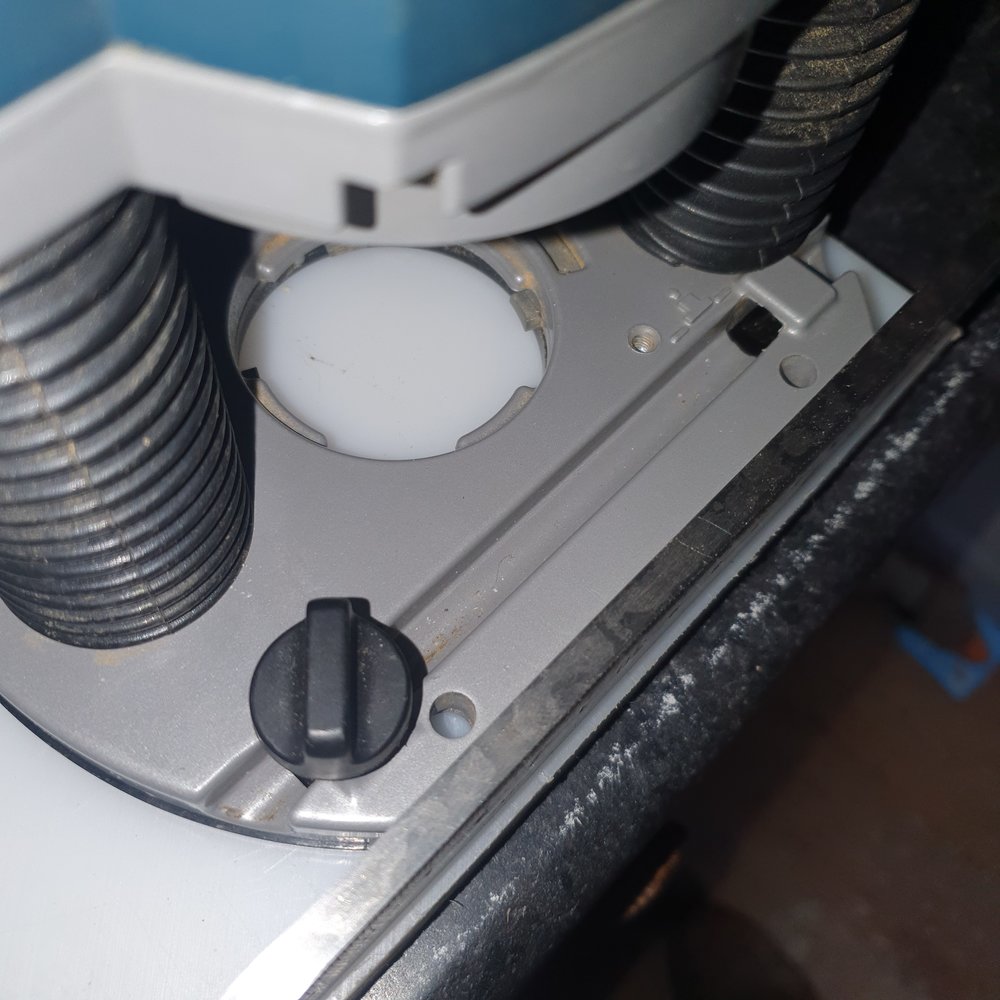

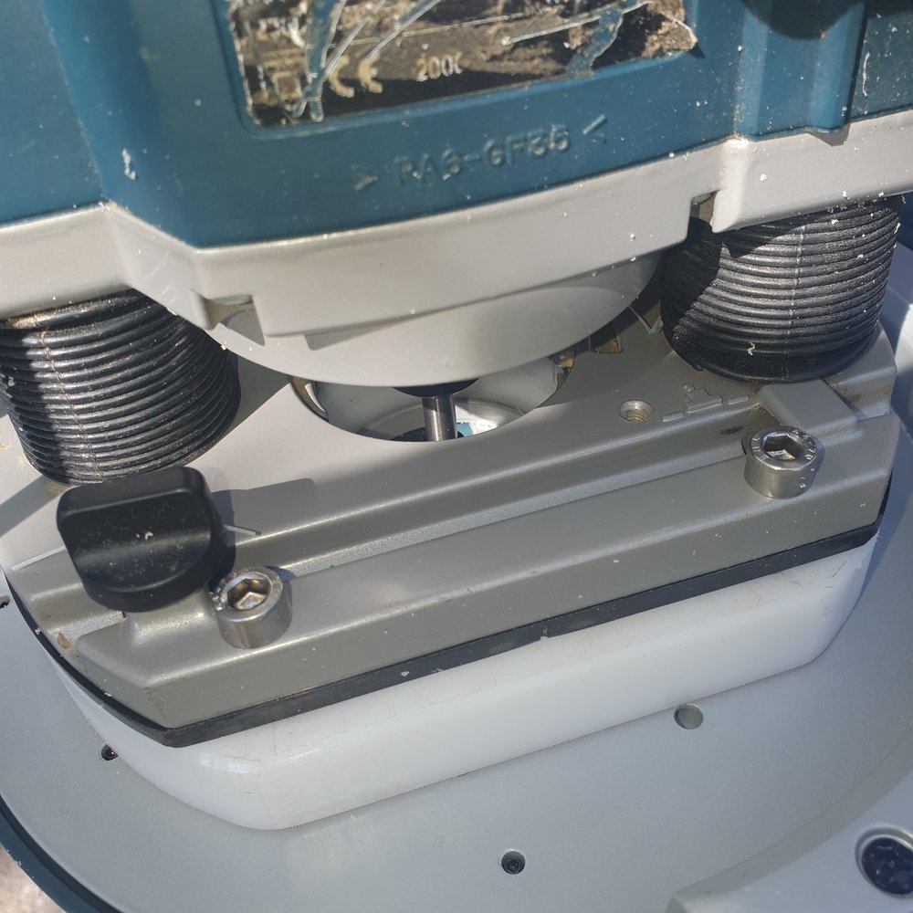

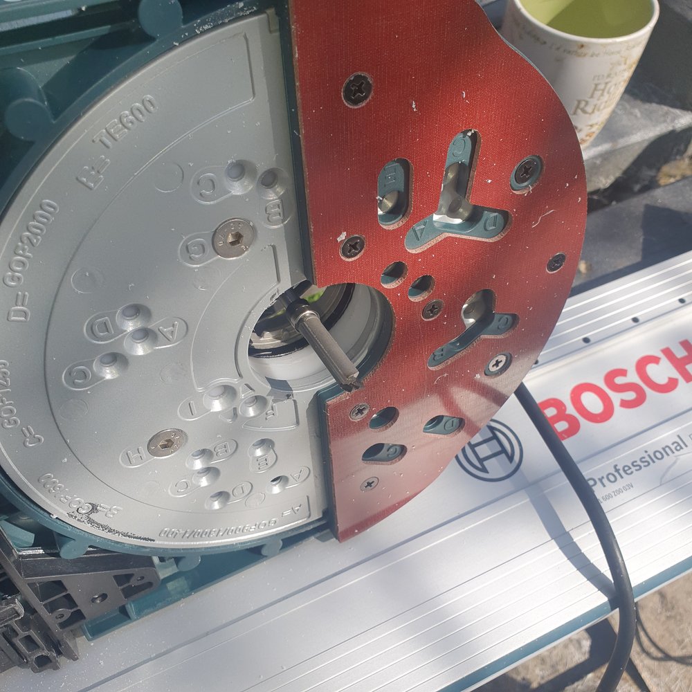

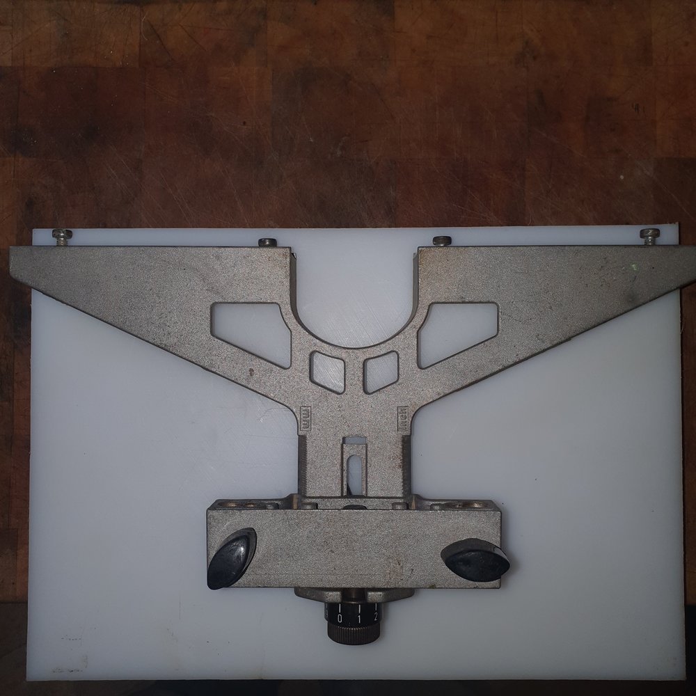

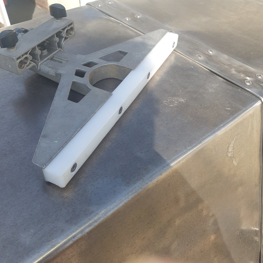

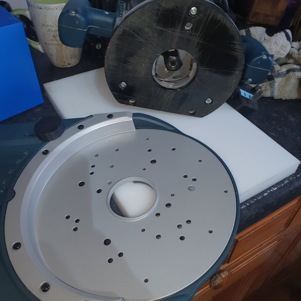

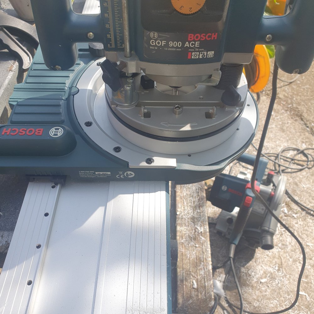

Something else worth noting if anybody else wants to make an adaptor..
I spent quite a while getting everything lined up by mounting the adaptor then using the router to drill its own center and then taking that out to the 51mm location lug used on the track adaptor etc.
I used the 3 plain holes (rather than the tapped ones holding the plastic base on) as there was a little play so I thought it would enable me to get the router perfectly central using a guide bush.
After actually using it I realised most of that effort was wasted.
It does not really matter where the cutter is relative to the track, as you will always have to adjust the position depending on the diameter of the cutter you are using.
So, basically, there is no need to mess about. The central hole in the adaptor could just have been cut square with a jigsaw or whatever.
The only reason I can think any form of accuracy would be needed is if you wanted to take the router off during a job, use it free hand, and then mount it back on the track again but even then, a quick wind of the offset dial would be quicker than lining up tightly fitted bolts or something.
