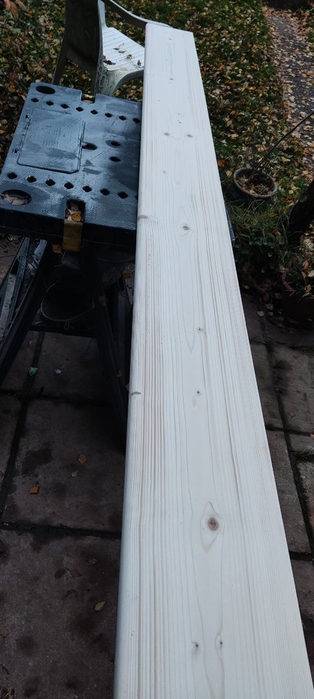

I've had this too. I'm going to try 2k epoxy primer next time!I've recently finished renovating a house all new skirting, architrave, spindles bannisters etc. I used knotting solution from different manufacturers, sometimes two coats and most of it has bled through. It drives me up the wall especially the stretch opposite the loo - for obvious reasons!
I asked a decorator friend and he said dig the knot out and fill over it - not the quick and easy solution I had hoped for so I am currently trying the zinsser shellac primer to see if that helps.
