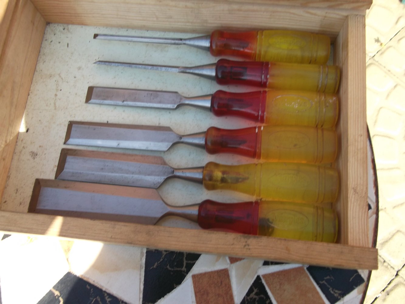

picked up a set of wood chissels at autojumble all marpl;es 20 quid . they were in a bit of a sorry state but can be sorted

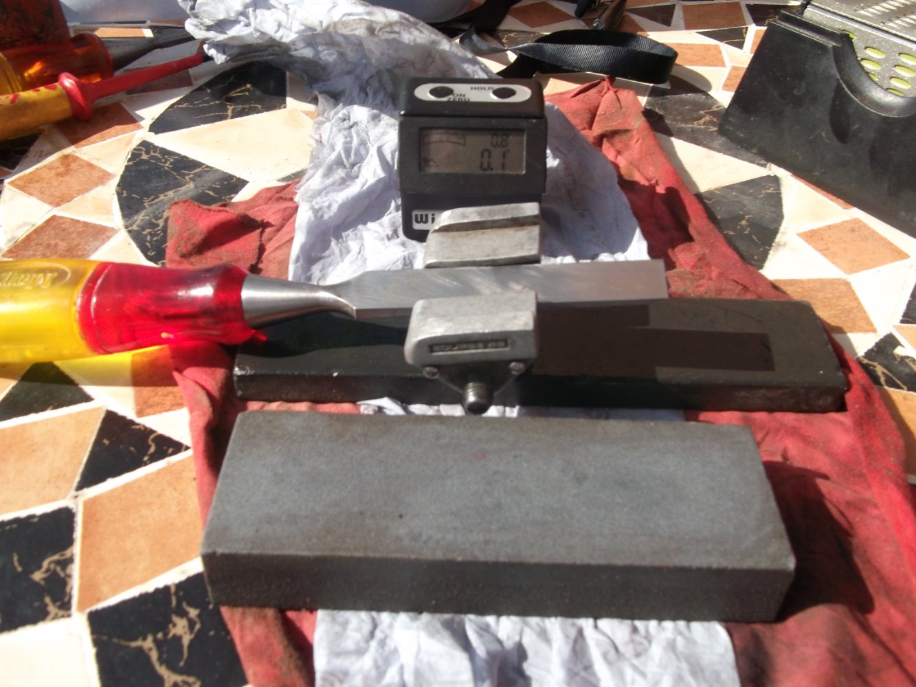

1st thing was de rust them and grind them back . put them on a jig i made for the belt sander and ground them back to 25 decrees then put them in another honing jig and ground the tips to 30 decrees , and rubbed them up by hand setting the angles up with my wixey angle finder quite a nice set now
could have just gone out and bought them for 80 quid and done a couple of hours work to pay for them but no fun in that 1st thing i did was cut my thumb sharpening them
