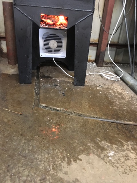

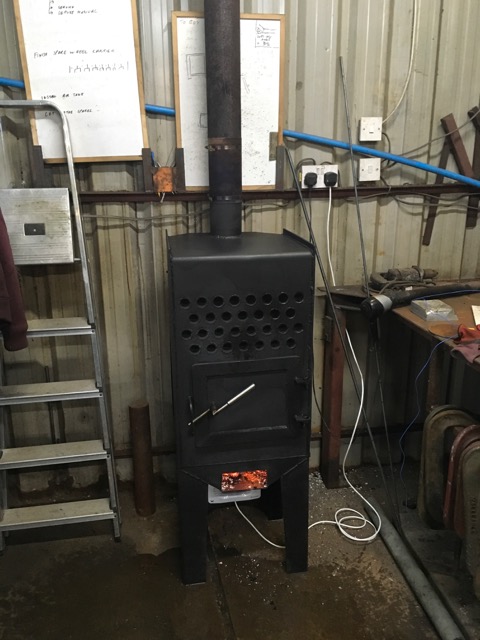

After seeing this video
watch
I decided to have a go at doing something similar
So a half hearted effort in fusion 360
https://a360.co/2vZcAZE
And then onwards
The fan at the bottom is a cheapo from screwfix which appears to give enough air moving. This blows into a chamber at the back which passes the air up the back and then through the tubes
The air coming out the front is about 100ºC and it moves around the workshop nicely
The heat exchanger is 30 x 33mm tubes which simply go through the firebox
The back is secured with a couple of screws so it can be removed quite easily to cut out any tubes that need replacing
