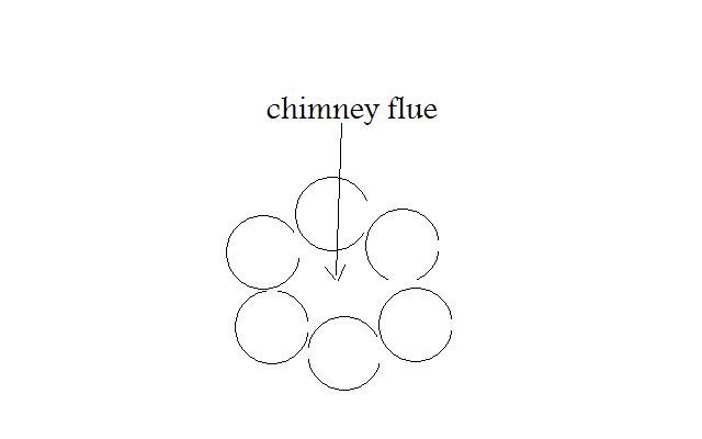

Right then, another wood burner topic :
Here's where i'm at. 47kg calor bottle, top cut off, 4.5 inch mild steel pipe welded directly on top.
Double A4 size door with hinges about 10 inches up, sealed with stainless plate.
Handle that was removed is inside with a grate sat on top....Whole thing is welded onto a 14 inch steel wheel, with a slot cut out. The bottom of the bottle has a 4 inch hole cut, and a slightly larger peice of steel is held in place with a peice of flat bar. Purely for easy of cleaning ashes.
Air intake to rear @ 4x2 inches
Choked intake at front from 2.5 inch exhaust pipe.
It burns well, but i think it could be better.
Should i weld in a baffle ( perhaps a brake disk covering half the flue ?
should i weld another pipe to the inside of the 2.5 inch exhaust pipe, heading half way up the primary chamber, to form a secondry heated intake ?
ANY advice very welcome !
