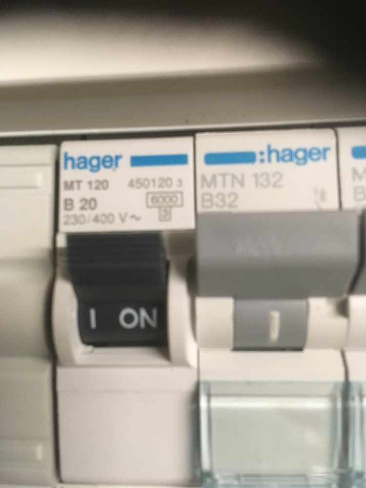

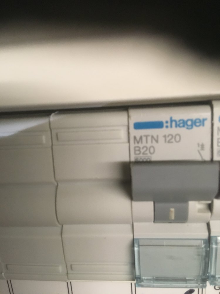

Back in July I purchased another Dakota 100. Upon the purchase the electrician came out and installed two separate dedicated circuits, one for each compressor with 20 amp breakers. Both circuits have three pin plug sockets.
A month on and the new compressor develops a fault. Upon start up the motor cuts our after a couple of seconds and fails to restart. The 20 amp breaker does not trip but the 13 amp fuse in the plug has blown. I contact UKHS and it’s decided a new motor is required. New motor arrives, fitted, all works.
Two days back the fault reappears. UKHS are contacted, this time it’s decided the capacitors are at fault. New capacitors arrive today, I fit them. The compressor fires up fine but on repeated attempts it NOW trips the breaker on start up only. The 13 amp fuse in the plug remains intact. No other appliance in use on the compressors circuit.
This is baffling, and ideas?? Thanks
