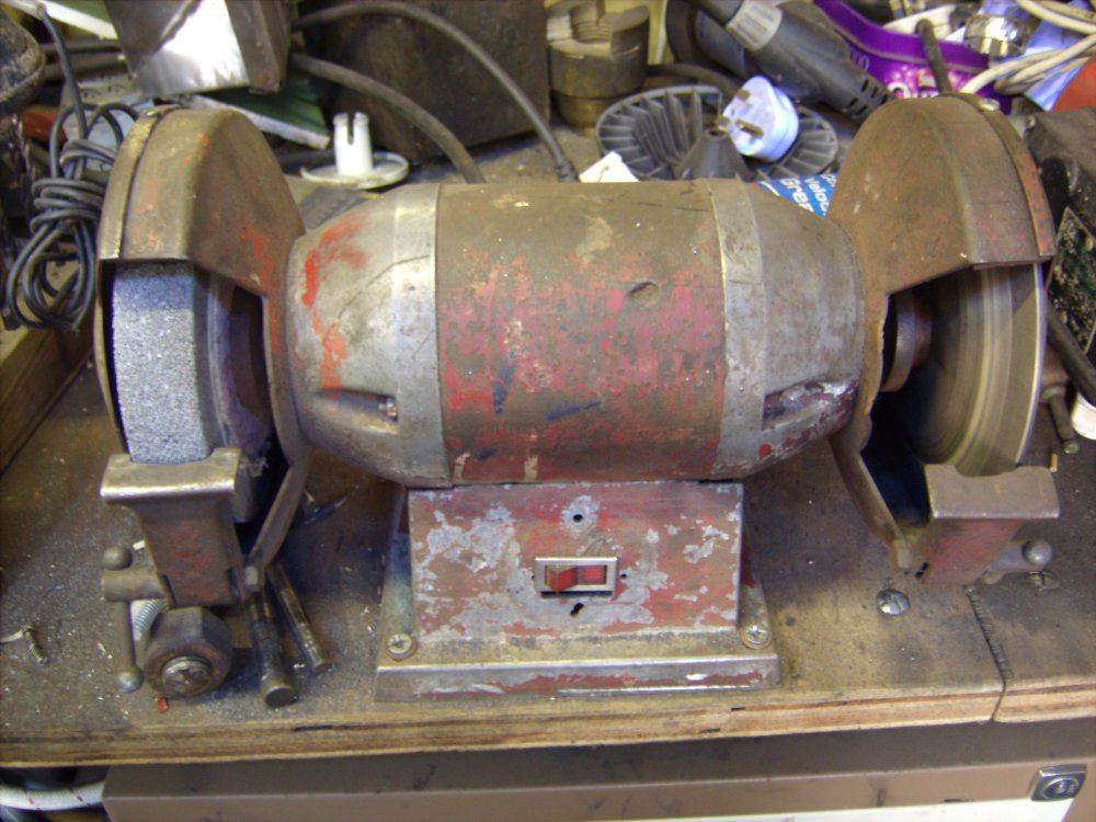

My 40 year old little grinder as above suddenly went to about half speed and little power while I was using it last week. I took it apart looking inside for brushes like an idiot (I don't know much about these things but felt I couldn't make it worse). No brushes in there and all looked good, tried it after changing the capacitor and off it went to full speed. The cap I took off was a 10uf and the washing machine one I put on is a 8uf so it's a bit slower at coming up to full speed. Just for fun I tried a 200uf cap which brought it up to speed much faster but I also noticed when I switched it off that it slowed to a stop faster. I thought caps were for starting and wouldn't affect stopping.
