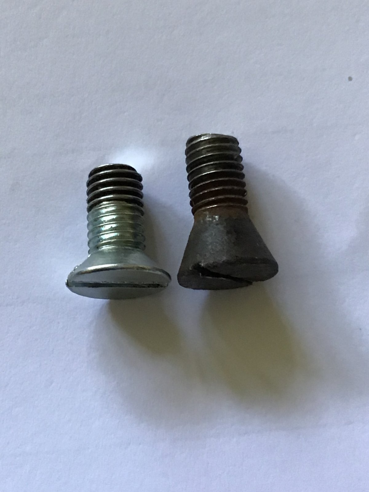

All suggestions welcome, thanks.
I know you said you don't have a lathe, but do you have a welder? Strip the plating off the sample screw you have by leaving in acid overnight. Blob some weld onto the head so it is bigger than the pattern. Chuck up in a drill by the threaded end. File or angle grind the correct taper onto it. Cut slot with hacksaw.
