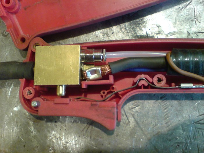

T twotone New Member Messages 2 Aug 10, 2013 #1 has anybody got a picture of the wiring in a Clarke 150en.ive got two brown wires, I know one goes on the trigger spring but where does the other go .

madkayaker Pro sparkey Pro Welder Messages 13,678 Aug 10, 2013 #2 I take it its the two brown from the torch? If I remember the other goes to the spare blade on the PCB

shenion Tool Pack Rat Messages 7,586 Location Stone Mountain, GA USA Aug 10, 2013 #3 Does this help? http://www.mig-welding.co.uk/forum/showthread.php?t=31369
wyn Member Messages 3,760 Location Cardiff Aug 10, 2013 #4 I had the torch apart on a clarke 151 once...from what i remember one wire went on the spring and the other was connected to nothing and was just tucked out of the way.

the snooper getting older by the day Messages 21,086 Location Hull UK Aug 10, 2013 #5 the wiring diagram shows both are needed
shenion Tool Pack Rat Messages 7,586 Location Stone Mountain, GA USA Aug 10, 2013 #6 The TE models use one wire, the EN models use 2.

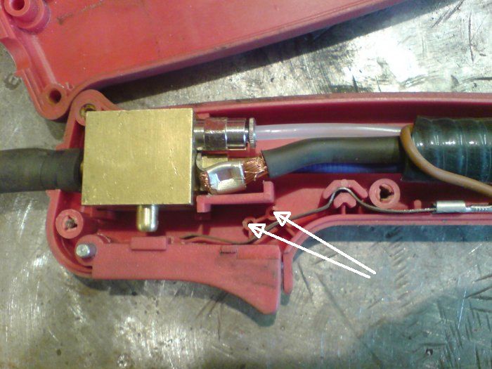

wyn Member Messages 3,760 Location Cardiff Aug 10, 2013 #7 This was the inside of mine....maybe it only had one wire.
shenion Tool Pack Rat Messages 7,586 Location Stone Mountain, GA USA Aug 10, 2013 #8 See the two holes marked? There is a small metal plate that goes in these holes, the second wire goes there on the EN machines.
T twotone New Member Messages 2 Aug 10, 2013 #9 thanks, I took it apart two years ago and forgot all about it
