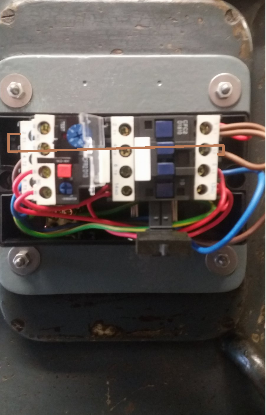

Yeah well spotted I didn't look that closely!The link that @daleyd added shows the link wire in a different place, remove the link between L1 & L2 and replace it with one between T1 and L2 so it spreads the load across the contacts
