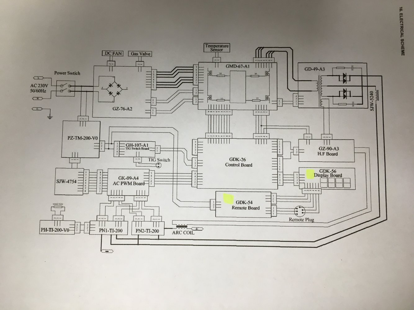

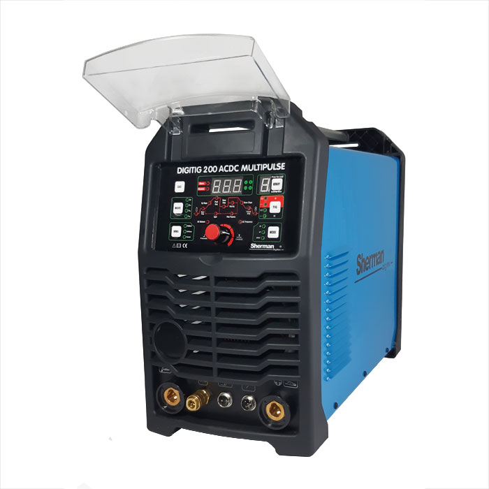

Hi,
I just moved from MIG welding to TIG welding and purchased a cheap Sherman 200ACDC multipulse...

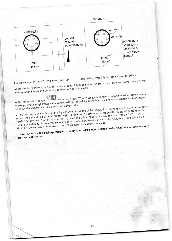

I would like to try and make a footpedal for it, as you can’t buy them.

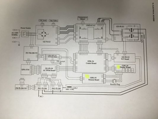

The only thing I have to go on is the diagram I attached to this… I have found no way of contacting Sherman.

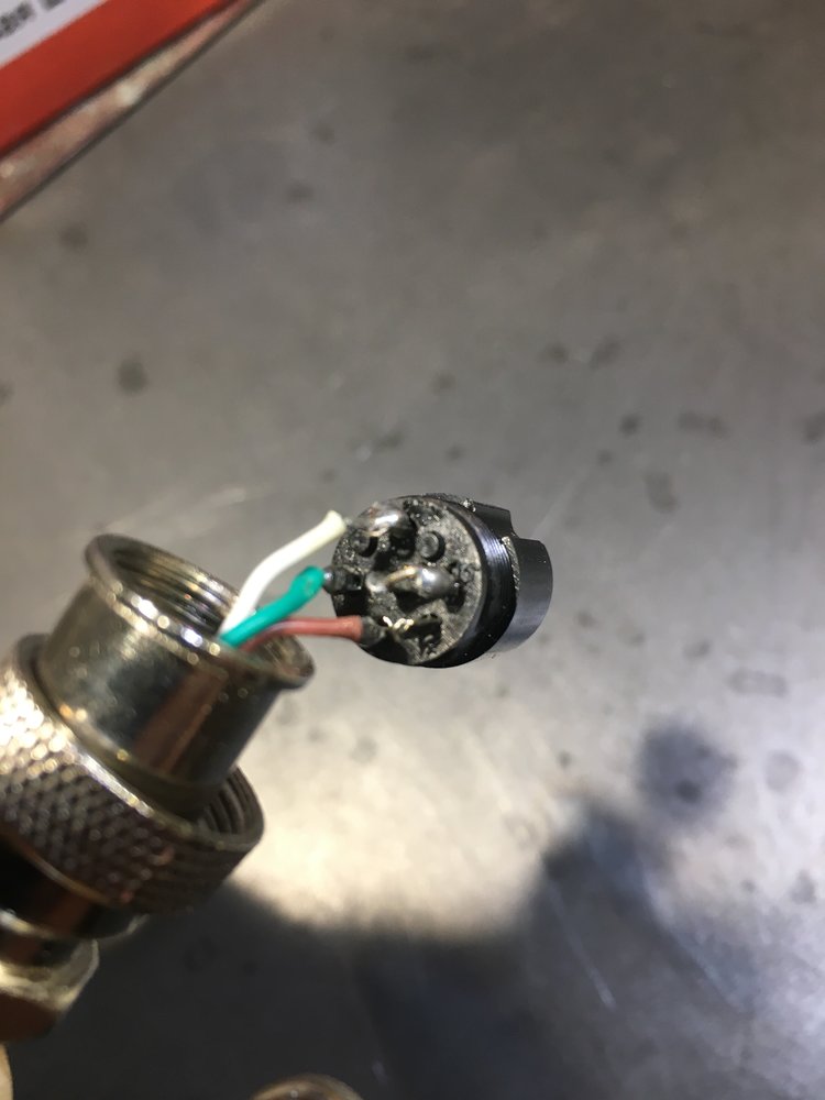

I have attempted to build a pedal, but I failed because I couldn’t work out the pins correctly.
Can anybody give me some tips on pin testing, or alternative ways of figuring this out?
Thank you very much
