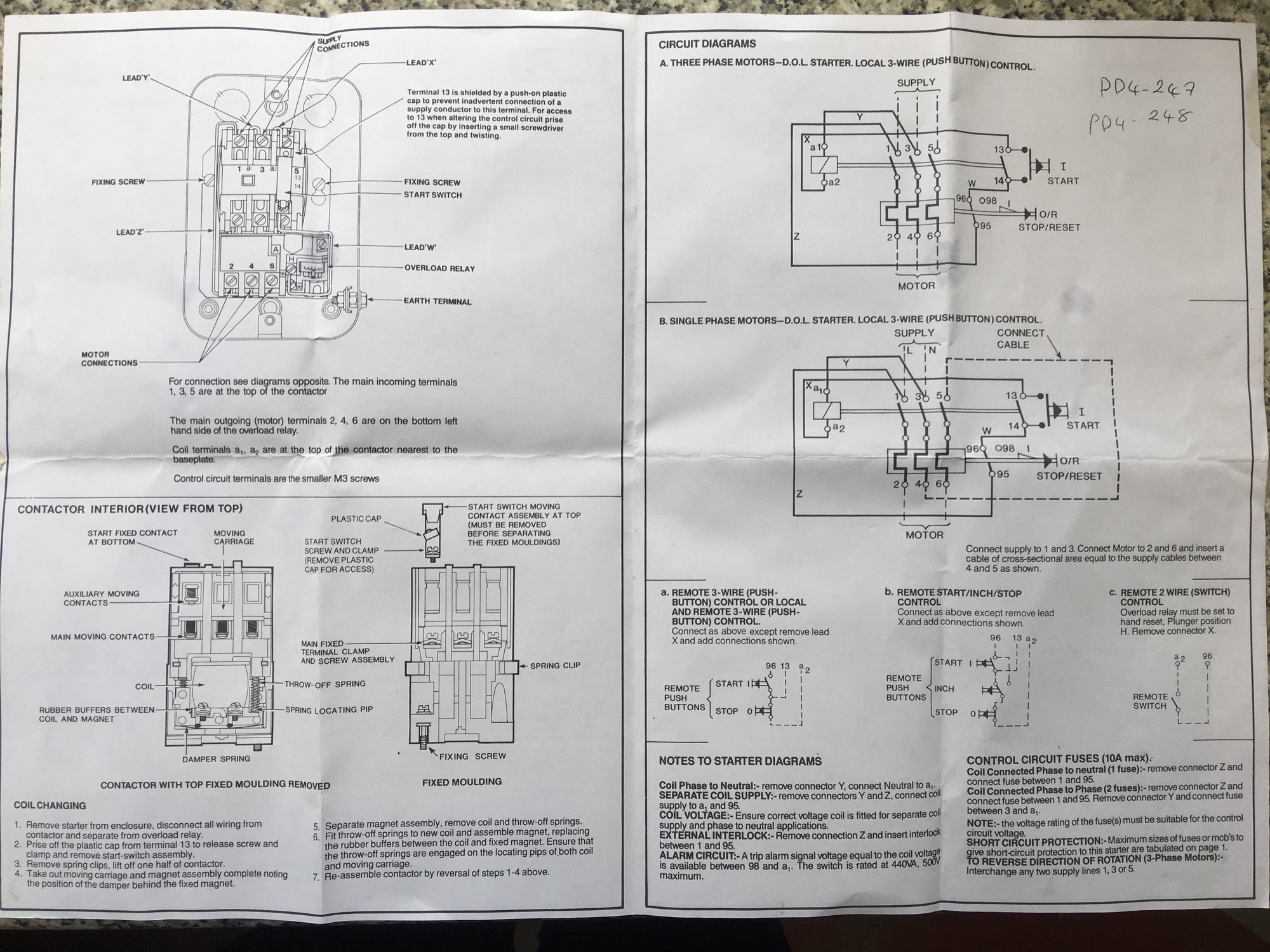

I have just fitted a New old stock MEM ADS7 DOL starter to my 1ph Boxford pillar drill, which is working perfectly. The drill however has an additional kick emergency stop with microswitch on the base of the pedestal which was disconnected many years ago when converted from 3ph to 1ph. Is there any way of wiring the kick stop to the ADS7 to get it to function?
I have attached the included diagrams that came with the ADS7 if anyone could suggest how to link it up
Thanks!
