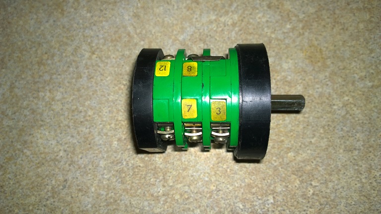

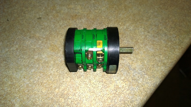

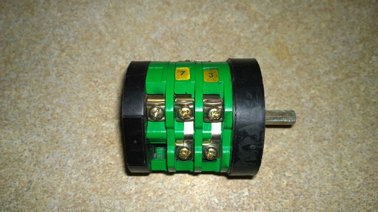

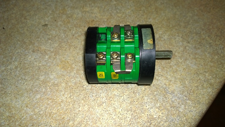

I have just rebuilt a tyre changing machine and am trying to wire up the new motor .
It is fitted with a drum switch for forward and reverse.
From the drum switch I have four wires.
2
3
8
12
I have numbered the wires from the drum switch as they are on it.
When the foot switch is pressed for clockwise turn I get:
2-L
3-N
8-N
12-L
When then foot switch is lifted for anti clockwise turn I get:
2-N
3-N
8-L
12-L
From the new motor I have four wires :
Red U1
Red U2
Blue Z1
Blue Z2
And a capacitor with one blue and one yellow wires.
On the terminal block to the motor I have six posts marked from top left to right:
W2/Z2 U2 V2
U1 V1 W1/Z1
Can anyone offer any advice as I am going round in circles !
