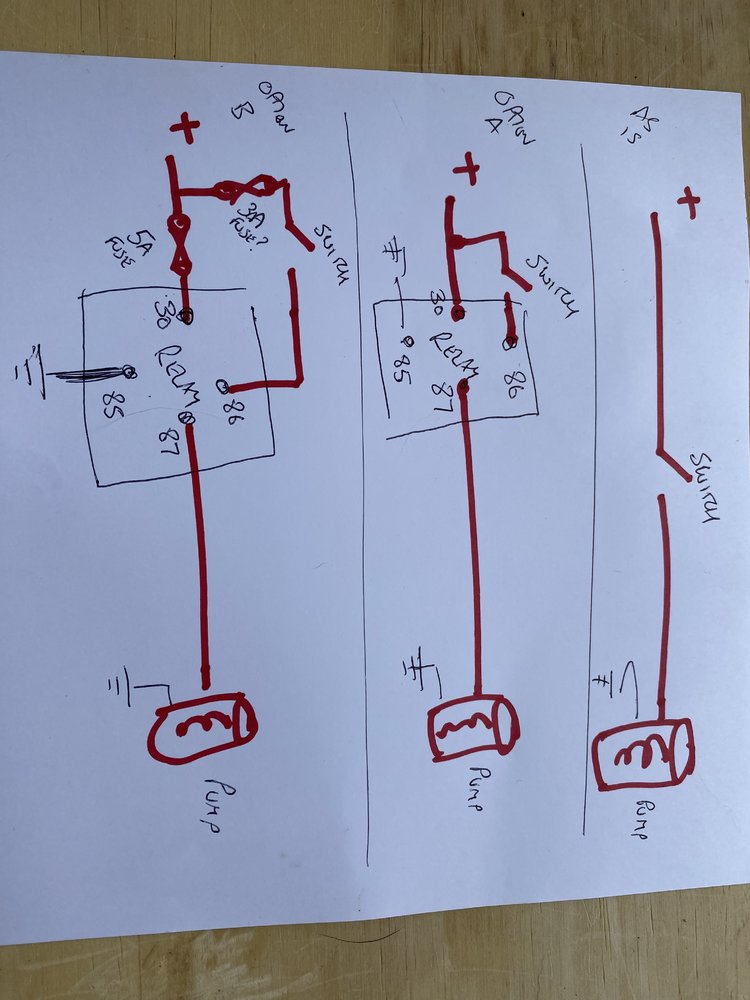

Hi guys, im adding a water pump into my van and have already run a two core cable from the battery to where the switch will be and from the switch to the pump.
Just realised the little 12v switches you get have pretty pants amp ratings so i will probably need to use a relay so the switch doesnt burn out. The max draw of the pump is 4.5a.
I've not messed about with relays before but it seems you need power from the battery to the relay, and also a power supply to the switch... as a lot of my units are now installed in the van running an additional cable will be a pain. Thinking about just splitting the power cable thats already there with a 3 way wago with one leg going to the switch and the other to the relay - Is anyone here all over this stuff and know if this is an acceptable way to do it?
