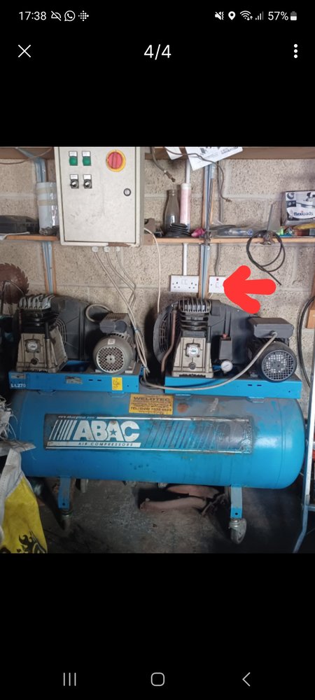

I have just bought a used tandem air compressor. Single phase, 32 amp supply required.

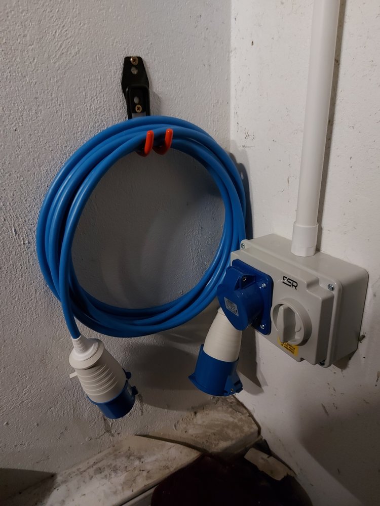

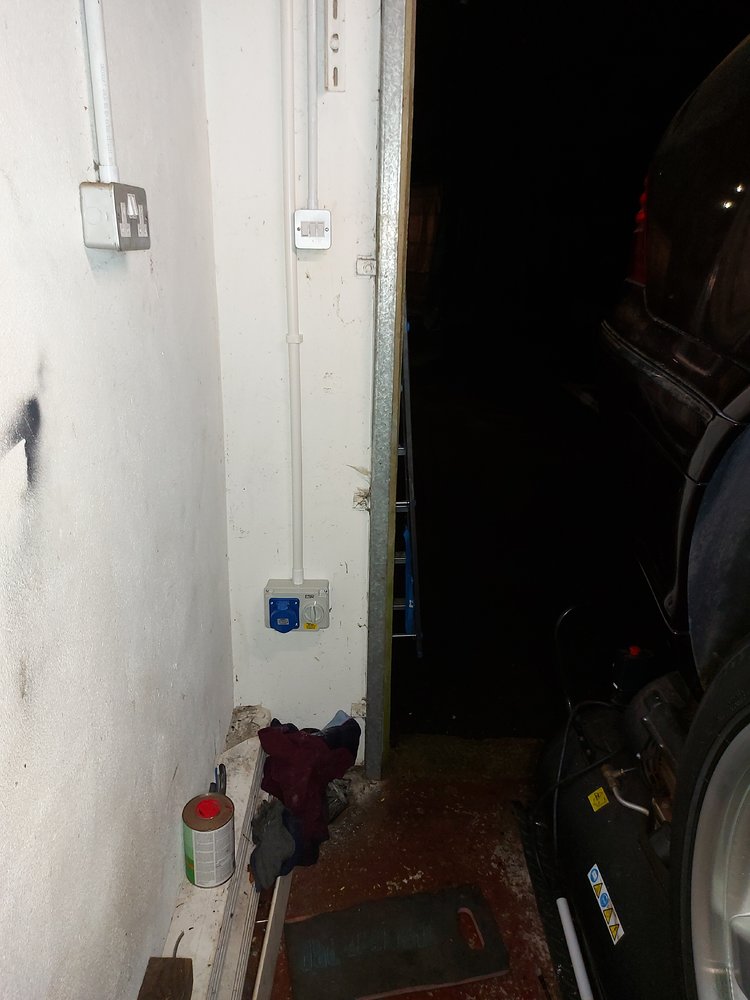

I recently installed a new dedicated 32amp welder supply to my rear garage. So I have the correct sized supply there already which I can tee off. (It has a type C breaker etc and works perfectly)

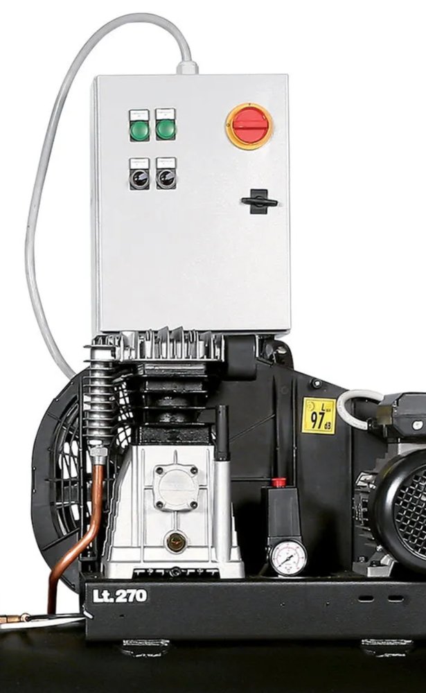

My question relates to the best way to wire in the compressor control board. It looks like this:

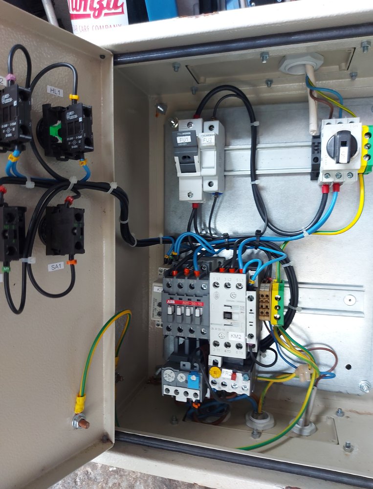

This is mine inside:
There is a red rotary isolator inbuilt to this panel.
Is it OK to bring the 32 amp supply right into the board? (For clarity it is fed from an RCD protected type C MCB in my main garage)
Or would I need to leave off a 32 amp socket beside it (can include isolator) and plug the panel in instead? So in effect it may not be considered as a part of the fixed electrical installation of my garage.
