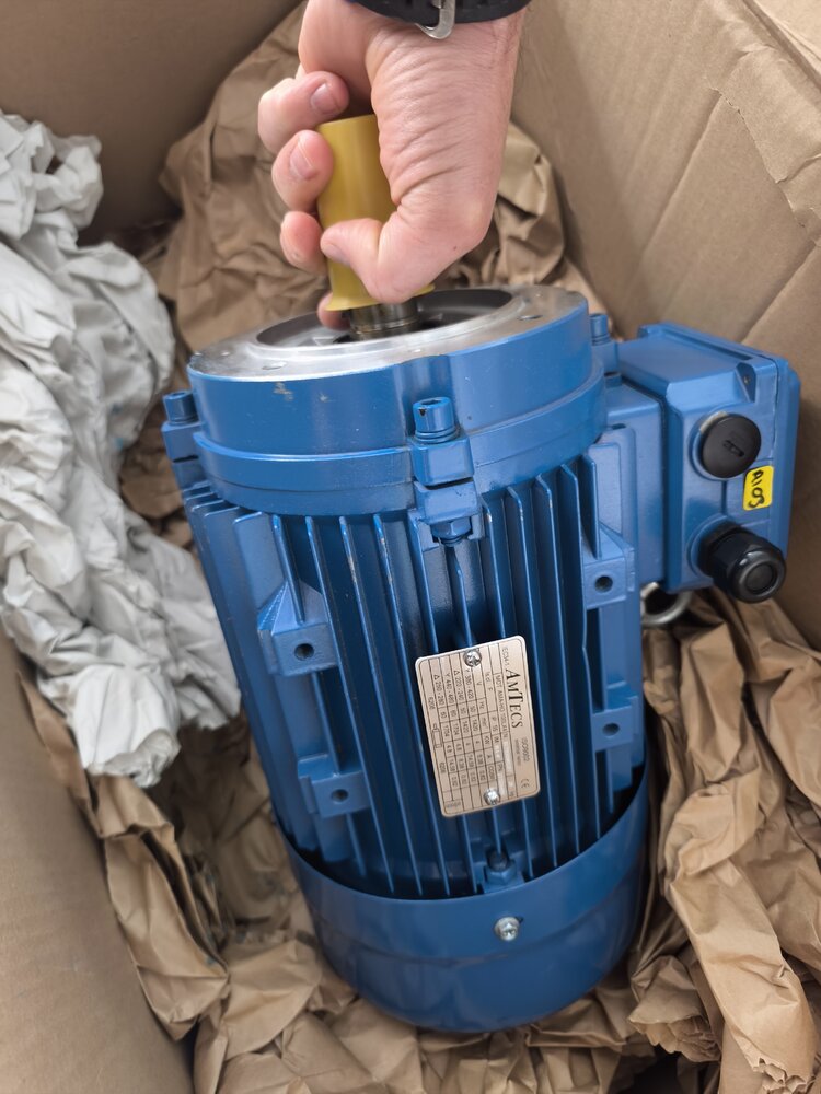

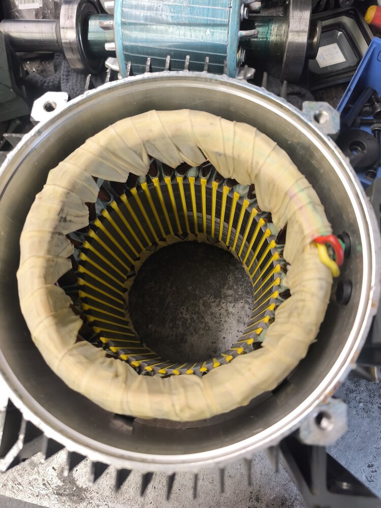

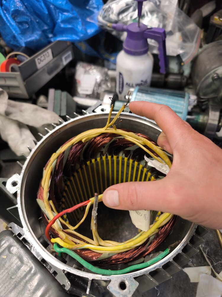

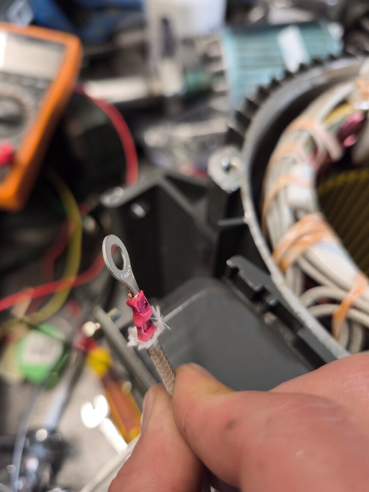

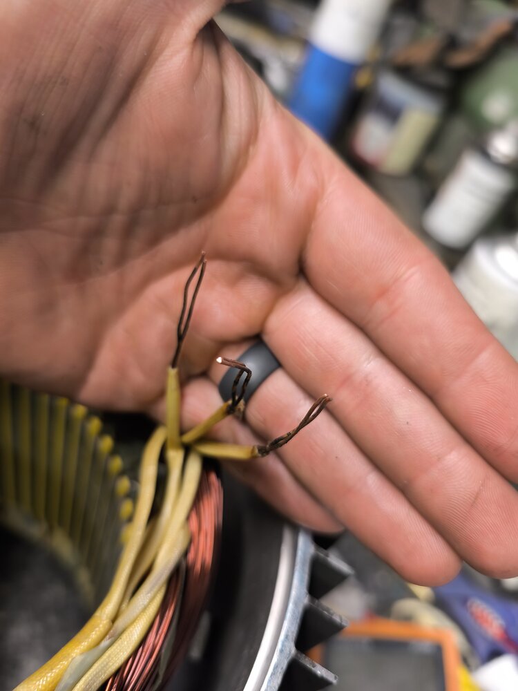

I have the same problem.

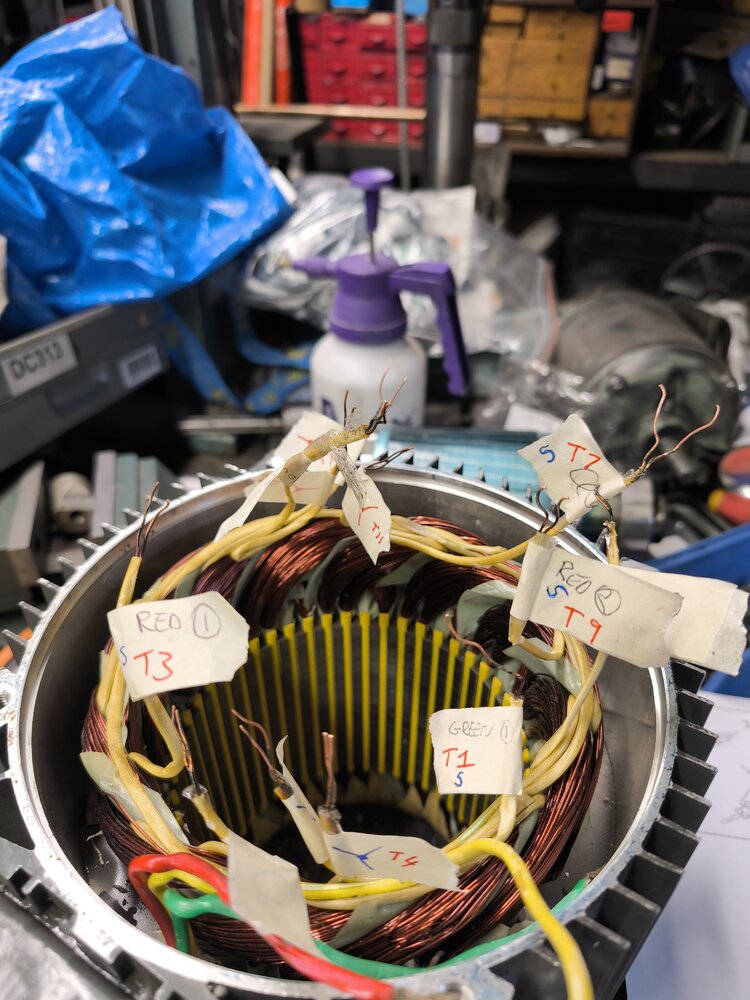

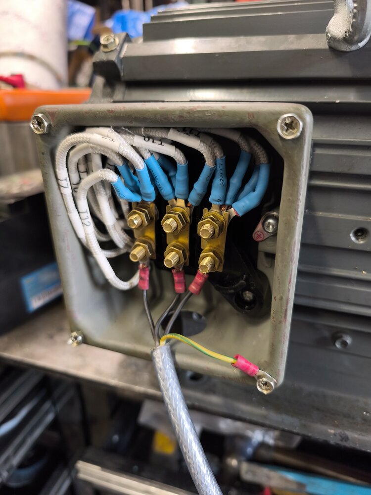

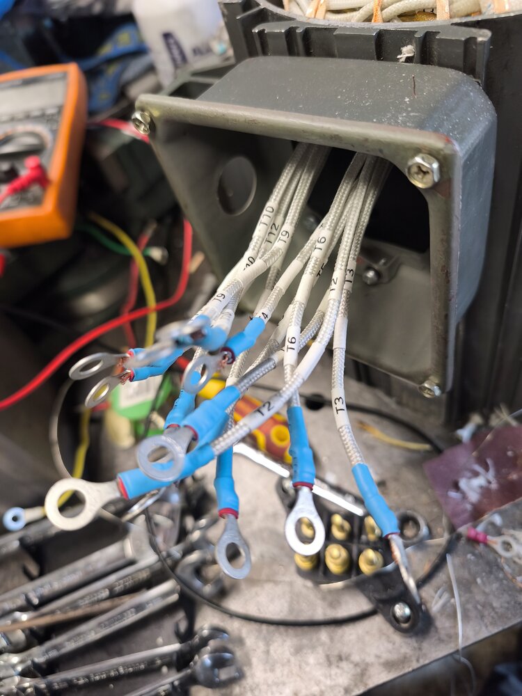

Most places just mention low or high voltage. Does not say if it is 220/400/700V.

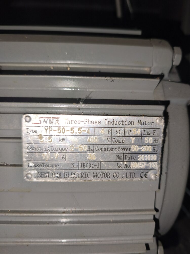

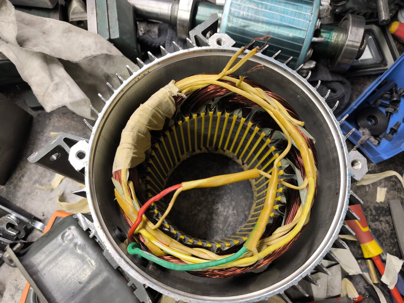

I have two major concerns with proceeding:
1. I am not 100% sure this motor can even be wired to 230V. It seems you guys think so, but are also not 100% sure.
2. I am scared I might do something wrong and damage it (it looks to be a really nice motor, 2-200Hz operating capability with forced air cooling).
The stakes are a bit less if you play with an old sub £100 motor.

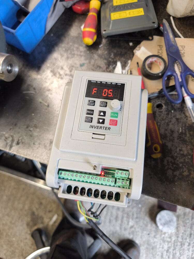

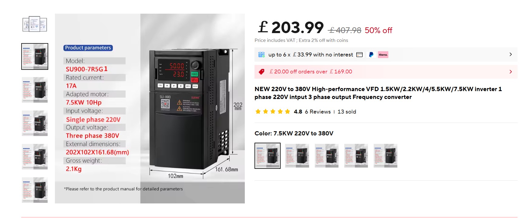

I wonder if I should go the 220V to 380V VFD route instead.

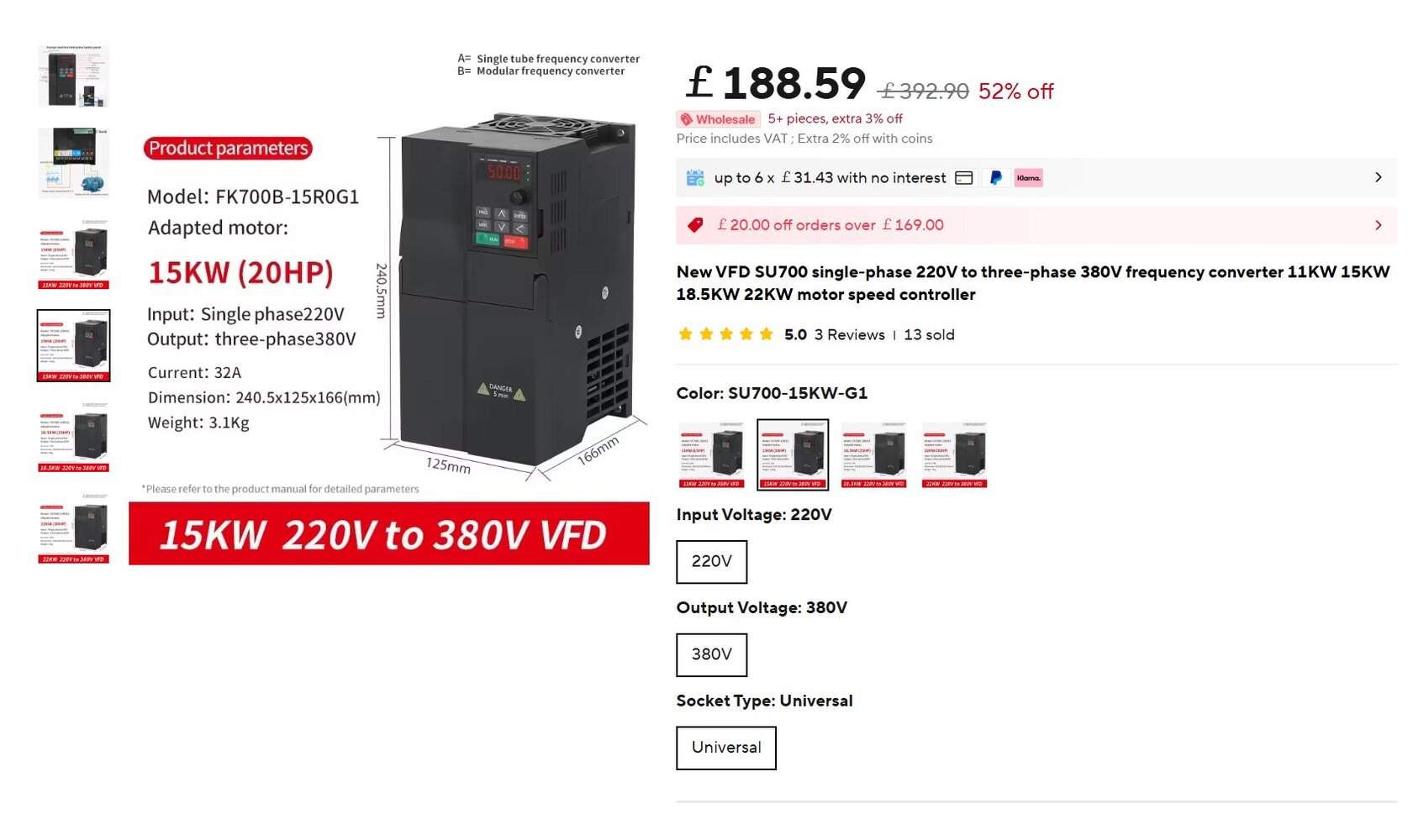

This was the first VFD I examined. Rated to 7.5kW.
Link
It comes from a relatively trusted supplier on Aliexpress.
It is also one of their newest model numbers (SU900-7R5G1).

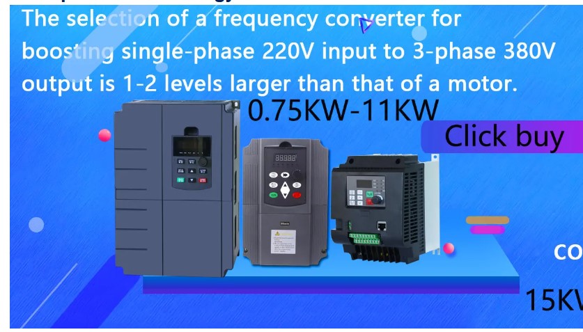

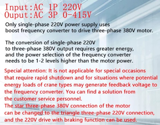

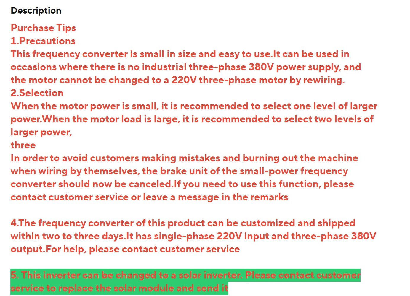

However, after browsing a little bit more, looking at different 220 to 380V VFDs, I came across the following types of warnings or cautions in SOME listings.
and
and
The warnings/cautions suggest that the jiggery pokery going on inside the VFDs to boost the voltage to 380 takes up quite a bit of kW capacity of the VFD.
There are also some additional warnings/cautions on SOME of the listings saying that 220V to 380V VFDs are not suitable to rapidly stop a motor/connect a brake - that will be a deal breaker on a lathe.
This, in turn, led me to the VFD below.
It is rated for 15 Chinese kW
, which in theory, should be good for my 5.5kW motor.
Link
The above VFD is a little heavier (3.1kg), which hopefully is a good sign that there are a bit more components/heavier-duty components inside
Options options options...........
and
and
