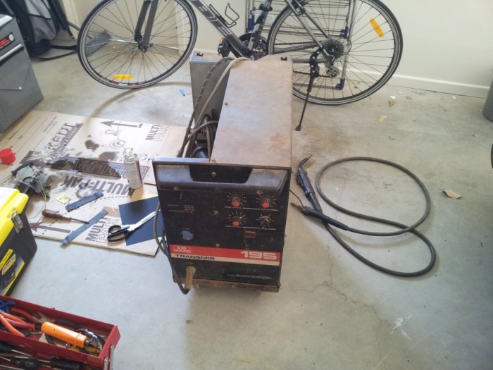

My first post as I have just picked up a second hand welder off my brother-in-law's father. So he gave me a Transmig 195 which is about 15 years old. This has done him very well on the farm but required to upgrade to a more powerful one.

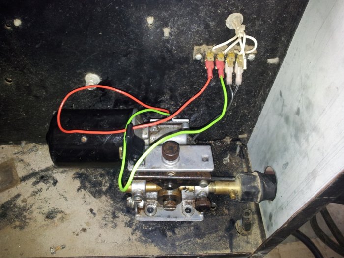

Anyway, he mentioned that the wire spooler motor has an issue and that it needs to be looked at. I have attached some photos.
When I set up welder and pull the trigger, the wirespool is very jumpy. Its not a smooth continuous motion and therefore, will be no good for welding. I am wondering how I can fix this? What I have done
- Pulled apart the motor and cleaned. I noticed that the brushes were quite short as the spring has almost fully extended
- After first clean, spooled evenly. However, after waiting a few hours, returned to welder and tried again. This time it again was jumpy
- Pulled apart again, cleaned and still jumpy
What I have setup
- no wire
- pulled the earth pin off the 15A plug because I only have a 10A wall socket. (when welding, will put back on the 15A earth pin)
If anyone can recommend what to do or if they require further information/ photos, please let me know
Had very little experience in welding so look forward to getting into it once I fix this welder up.
Cheers
