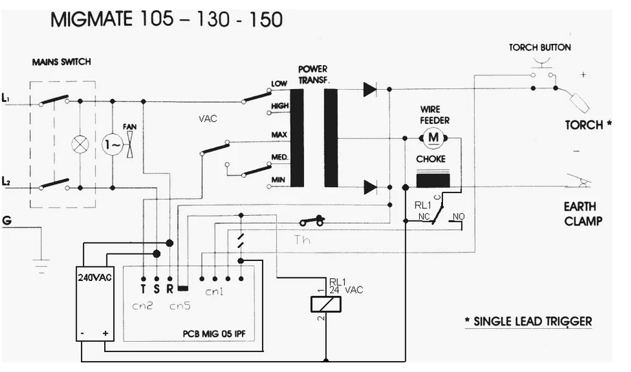

S sip New Member Messages 3 Location england manchester Apr 17, 2022 #1 Got a sip migrate 130.they are two black wires coming from the torch.where do they go .in the welder

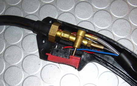

mike 109444 Member Messages 4,805 Apr 17, 2022 #4 sip said: Got a sip migrate 130 welder they are two wires coming from the torch where do they Ygo .in the welder Click to expand... You might want to post up a pic of the wires/torch to allow someone to give you guidance. And welcome BTW

M masleeve Forum Supporter Messages 214 Location Glasgow, Scotland Apr 17, 2022 #5 2 wires ? The diagram I have shows one , and my own one had 1 before I modified it to take a Euro Torch. There may be another version.

mike 109444 Member Messages 4,805 Apr 17, 2022 #6 I am guessing this is a "replacement" torch that comes with two wires. The one in the attached pic has two wires in the torch end but one of those two (red wire) connects to the welding power feed to tip. Other connects to pcb four pin plug (CN1).
