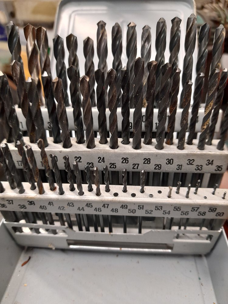

they all have a metric equivalent . there used a lot in model engineeringI have lots of drills. Probably too many. I've not met a need for these, but maybe I am missing something?i have a set of number drills why arent you going to use themthey all have a metric equivalent . there used a lot in model engineering
What would these drills be used for?
I keep drills for tapping with their matching taps and dies. Already got far too many!Use the number 8 as a tpping drill for M6 threads.
Once there are 59 more post following this, you will have a full set.
well they will say that there in business to shift gearHaving a nose through the Dormer twist drill and reamer handbook the No 80 drill is 0.0135" or 0.343mm, however it states at the bottom of the page " Gauge and letter sizes are no longer recommended British Standard drill sizes. Every effort should be made to use the alternative Metric or fractional sizes shown in our catalogue". There's no date of printing apart from Edition 476 but I'll guess '70's.
