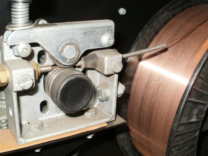

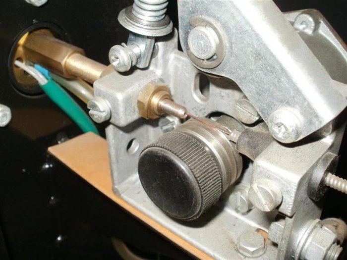

Trying to teach myself to weld with an old but reconditioned Eland 130. Spending more time rethreading the wire than welding because the wire keeps kinking and looping just ahead of the pinch roller before it goes into the liner. The torch assembly is pretty new and I've lined up the feed so that its in a straight line with the liner, but still , at the least resistance it buckles up. Maybe I'm missing something here, but surely, if the wire is being pushed over several feet, it will inevitably back up as soon as it hits the work? I thought it must just be me, but a mate who welds all the time tried it and it kinked straight away on him.
Any advice please? Steve.
