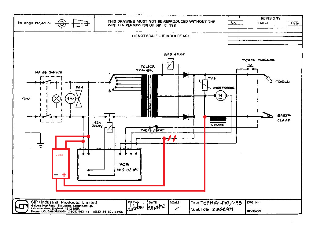

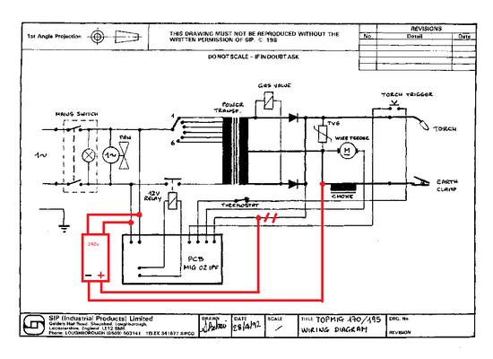

hi, i'm going to have a go at wiring in a separate power supply for the wire feed tomorrow, thought i may as well just get it sorted and have a go at bracing the wheels a bit.
i've seen a lot of advise on wiring a transformer/power supply and this is what i think i'm going to go with, does this look ok? i'm fairly competent with electrics and have worked on lots of wiring looms but i'm not gunna lie mains electrics scare me haha just wanting to make sure i'm not going to fry anything, its a 19.5v 4.62a laptop supply.
cheers
