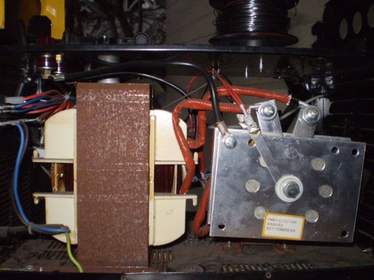

I have also had trouble with my speed controller on this machine. I have traced out the schematic as best I could. Speed controller schematic
Mine was running at full speed. It turns out that resistor R6 was open circuit.
